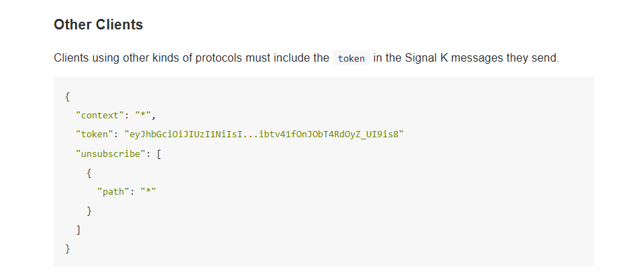

Are you sure the token is supposed to be in the body?
Typically, it would be in a header, in the form Authorization: bearer ey...
Do you have the doc of the API?
EDIT:
If this, the token should be in the root of the json request, not under “login”

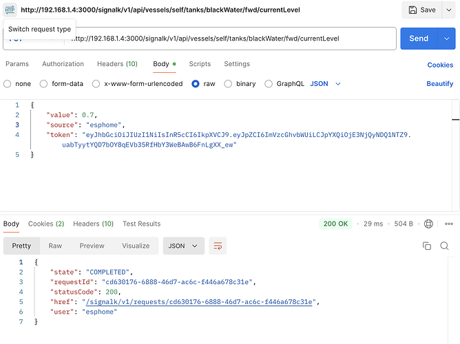

I got distracted with a few other boat projects, but I am not back looking at this. I tried with your suggestion and that works with Postman as per the following screen shot.
Here’s my esphome YAML.

But, still getting a permission error. As you can see the Post was successful and I am able to retrieve the Token.
