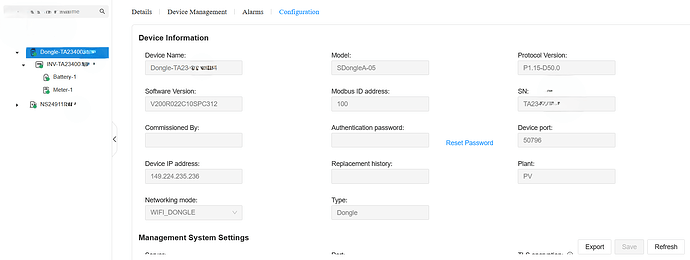

HA runs on a Synology NAS via VM. The inverter is connected to the same network via SDongleA-05 via FE. TCP is unrestricted. The IP address of the dongle is 192.168.178.183 (static). I have attached 6 screenshots of all settings. Have I overlooked anything?
In Fusion Solar the Modbus ID address is 100, but I have also tried AUTO, 0, and 1. For the port, I have tried 502, 6607, and 50796. I have tried with and without “Increase permissions.” (…and every combination of all these entries)

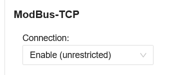

WR setting: Modbus TCP: unrestricted
Ports tried: 502, 6607 (but found 502 the only one open, so…)

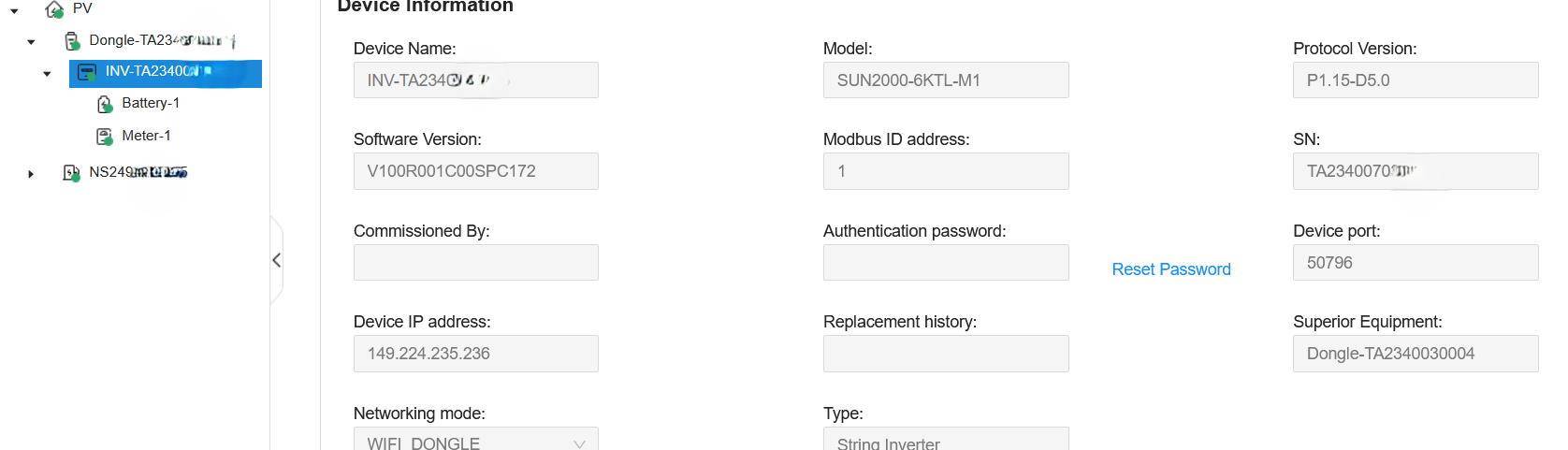

Ids tried: 1,2,16,100, AUTO (suspect it is ID 2 in my case)
I have no installer rights in fusion solar but access the devices locally.
So where can I see the ID exactly?

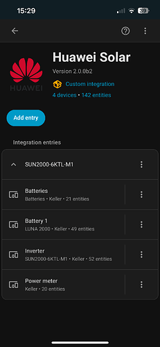

I have no long-term experience with it, but at least it brought the connection to live, and I could see values for the first time.
So the combination of HA OS 2026.1.0 and Version 2.0.0b2 does it better for me than the standard release of this integration with it.

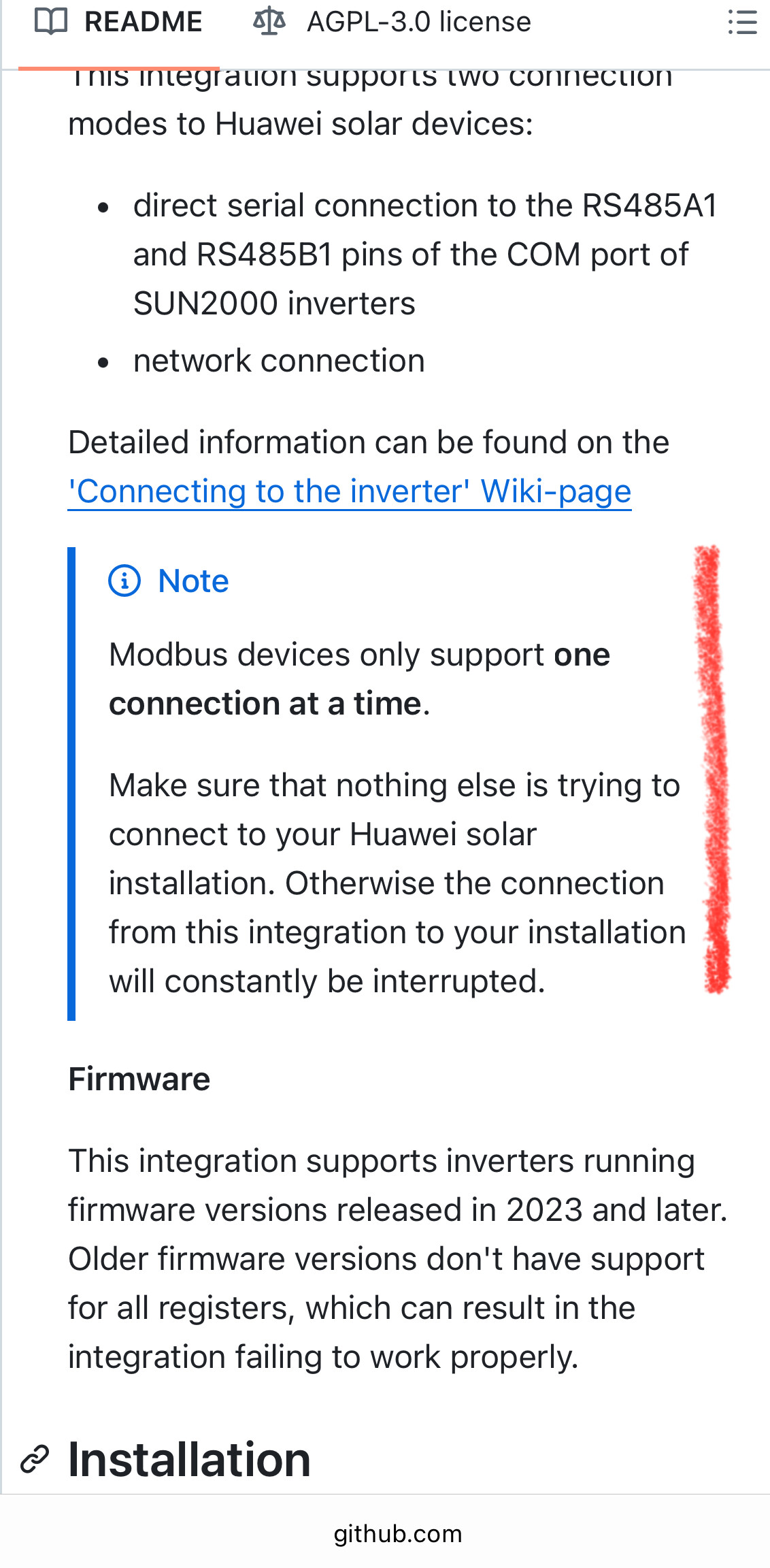

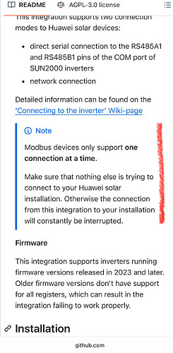

How do you interpret the information on GitHub that only one connection at a time can be established?
The dongle is also used to communicate with the cloud/app and with the batterie too? (Not quite shure on the latter). I have no cascade but the battery.
Could it be that if the cloud/app and/or battery communicates, the communication with HA is not possible?
It’s working :smile:! But - the wall box is not listed and I see no Wallbox related entities.
Does anyone know why the wall box is missing?
No, it should not affect the connection into the cloud. It just points out, that you better have only one client consuming the Modbus TCP service. Unlike Modbus RTU Modbus TCP does technically allow more than one client.
But here, having more than one client will cause serious trouble, so better leave it at one.
Nevertheless, if you are accessing the inverter per RS485 and consuming Modbus RTU, you are technically bound to have a 1:1 connection only.
