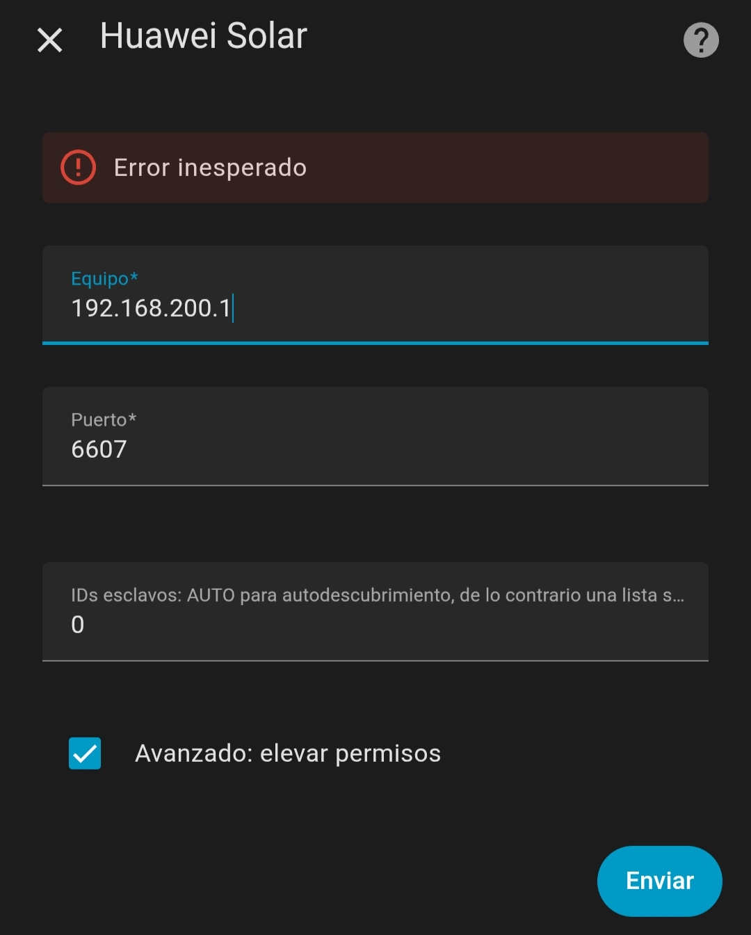

I tried for a week, and even thought about getting a dongle… But now connecting HA directly to the inverter AP and using IP configuration I can get some data.
I just can’t use the advanced mode, I always get an error, I can’t even set the supervisor password.
Is there a way to make it work in advanced mode?
What do you mean the advanced mode?

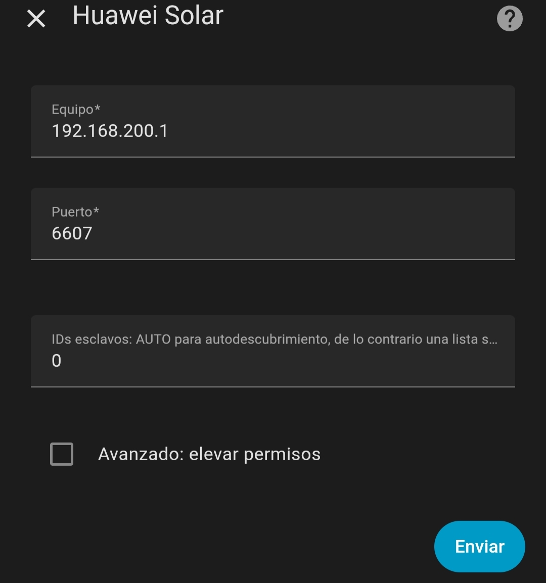

I mean that if I try this:
It works just fine, but if I select advanced (spanish translation, not sure what it says in English) I get an error:
I would like to see the optimizers and all the advanced stuff, any idea?
