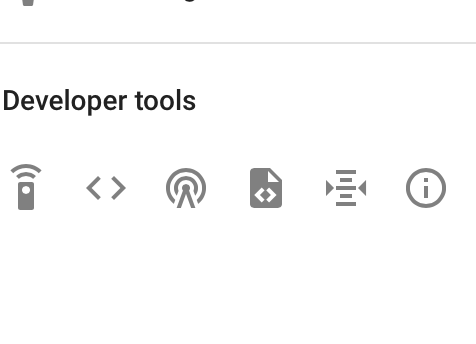

Have you tried copying and pasting your template into the template tool in developer tools
4th icon to the left
now i did it
Error rendering template: UndefinedError: ‘None’ has no attribute ‘attributes’
