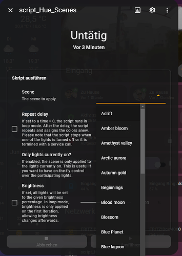

Hey Nils,
first of all thanks for this blueprint. If I run it as script I get the possiblity to switch the scence…But I just see the dropdown list of names…no color indicators or pictures…
Sorry for that question…but Im freshly new to HA. :slight_smile:

Is there a possibilty to have something like this?
This is currently used with my Hue Bridge but I would like to switch. :slight_smile:
Screenshot 2024-06-29 194409
@Tramatnois Yes, I’d like to have something more colorful or structured as well, but it is (as far as I know) not possible inside the blueprint (because drop-down fields don’t have that option).
You can, however, create cards that call the script. These can have arbitrary images. I currently have this on my dashboard:
It’s essentially a grid card with image cards.

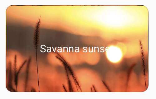

Not really below, but with this card (button-card), you can show the text in front of the picture (which creates new problems w.r.t. readability …).
Screenshot:
Screenshot 2024-07-07 at 07.15.05
YAML:
type: custom:button-card
show_icon: false
show_state: false
tap_action:
  action: call-service
  service: script.turmzimmer_lichtszenen
    scene: Savanna sunset
    repeat_delay:
      hours: 0
      minutes: 2
      seconds: 0
    onlyonlights: false
    brightness: 100
  target: {}
styles:
  name:
    - color: white
  card:
    - background-size: cover
    - background-image: url("/local/hue/Savanna sunset.jpg")
extra_styles: |
  :host {
    height: 100% !important;
    width: 100% !important;
  ha-card {
layout_options:
  grid_columns: 2
  grid_rows: 2
Oh, but using the mushroom template card, you can show it like this:
