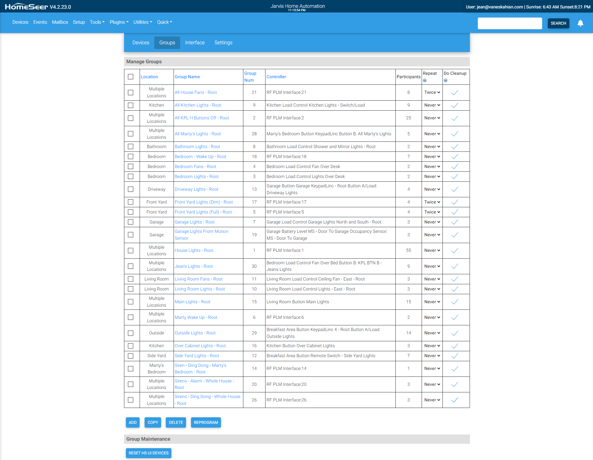

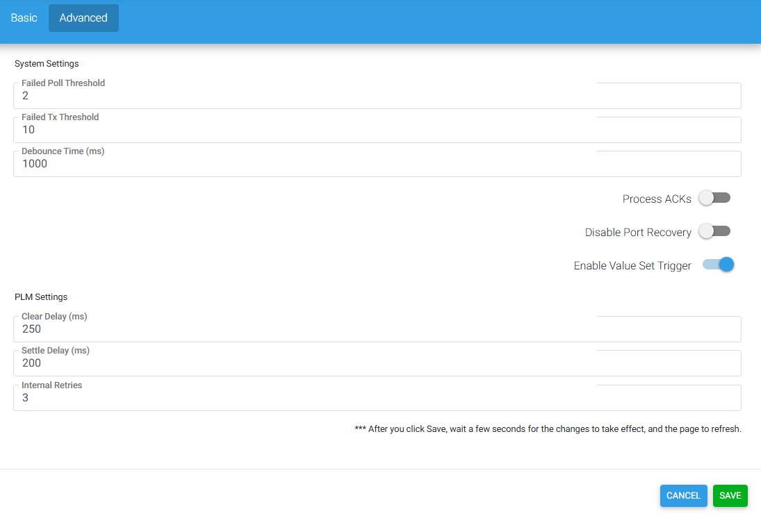

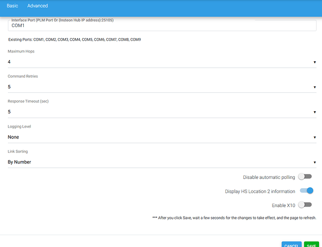

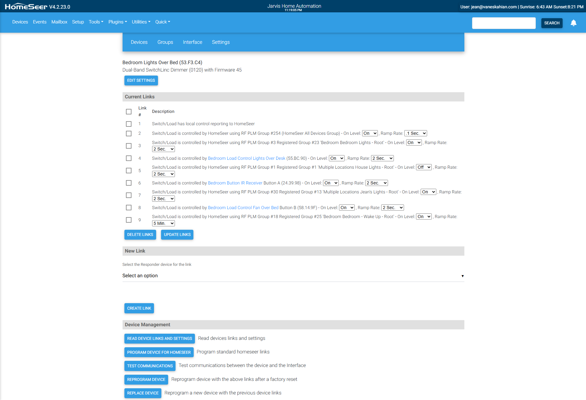

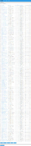

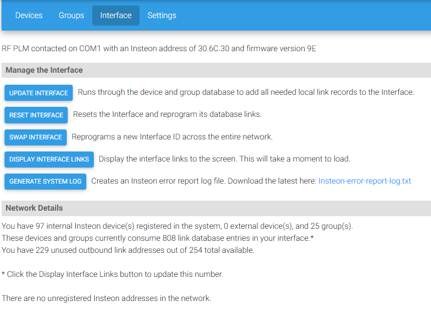

@OldSurferDude , like I mentioned I have used the UD ISY and Insteon PLM before. It is good, but not as good as HomeSeer using the Insteon MNS Plugin. If I must use something other than a native Home Assistant integration (that we agree you have to because the native Insteon support HA is not very good) then I will stick with what I have in HomeSeer. All the features you talk about (and many more) are available to me.
  • Backing up and restoring to a new PLM
  • Replacing Insteon devices and restoring a config from the one that was replaced
  • Testing Insteon Coms (pings)
  • Polling Insteon devices
  • Enrolling a new Insteon mains powered device without needing to touch the device (just using the address)
  • Generating native Insteon links between devices
  • Managing Insteon groups and enrolling devices in groups
Here are some screenshots so you can see what I am talking about. This is just a small sample of the settings. There is much more. It is amazingly powerful! Home Assistant needs at least this and it should come from Insteon directly!
