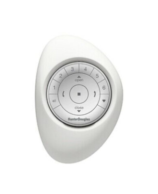

Note, the “pebbles” do not interact with the powerview hub, those control the screens directly, which is good, because even when the hub is down for whatever reason, you still can control the screens manualy
What are pebbles?
Remote controls.
