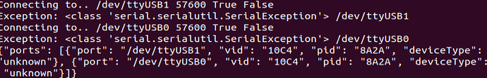

HUSBZB-1 Z-Wave firmware portion update
I just set up Home Assistant the other week with a husbzb-1 that I’ve had laying around for a few years. Came across this post and was curious about the S2 support being added in the newer firmware versions since it seemed like it was working on mine.
My husbzb-1 has firmware 4.32, but my S2 devices will say they connected with S2 and show that as their security level. Is this not reporting correctly? Or is there missing features in the earlier firmware? And should I upgrade if I want it to be working correctly with my locks?
Are you using OZW or zwave2js? I’m using zwave2jsmqtt, the config options would let me generate and store S2 keys, but nothing would connect above S0_legacy. I just finished the update, but haven’t tried to re-pair any of my S2 devices yet.
I started with ZwaveJS then switched to ZwaveJS2mqtt the other day for the nice control panel…but under security level it says S2 Authenticated. My firmware is a tad bit newer than the OP it looks like so I guess it’s possible it was added between those version.

I am trying to do the exact same, but i am unable to pass through the USB device. When i run “./ncp.py scan” i receive an exception.
I have added Oracle VM VirtualBox Extension Pack in the same version as VirtualBox and added the USB device as a “USB 3.0”.
Hope you are able to clerify.
Not sure exactly. For me using VirtualBox I just enabled the USB device from the icons in the bottom right corner of the VM window (not inside VM, but on host). From there I activated USB for the zigbee device and it worked for me.
Just stumbled upon this thread. I have all the required software and drivers installed, but VirtualBox simply will not load the drivers for the HUSBZB-1 stick. It shows up in device manager as no drivers loaded. I can force load them by right clicking the .inf file and then Install, which it does, but the device still cannot find the drivers. This is Windows 10 w/latest updates running on VirtualBox 6.1.34 hosted on Fedora Linux.
Any ideas or suggestions would be greatly appreciated.
Did you make sure to install the VirtualBox Extension Pack? Have you gotten your HUSBZB-1 working at all or is this your first time setting it up? If this is your first time, I would suggest getting it working first, since this thread is about updating the firmware, which is a bit advanced.
Hi David, thank you for your reply. I have been using VirtualBox for some years and yes, I updated the Extension Pack as well as the Guest Additions. It had been months since I last used it so I spent a few hours updating Windows 10 as well.
As there were several Windows CP210x zip files available, I decompressed them all and found the one that supported Windows 10. This would be the one named CP210x_Universal_Windows_Driver.zip which claims both Windows 10 and Windows 11 support.
