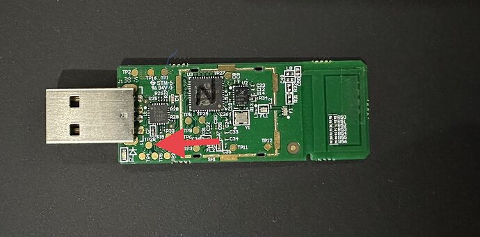

Attached a photo of this, in case anyone else needs a better visual of where TP28 is located.

Sorry to post on an old thread, but I’ve done this before on a stick and it worked, but trying now by following the process and grounding the TP28 I just can’t get it to READ. Any tips? Wondering if people have had issues with USB3 ports vs. legacy, etc etc.?? Any ā€˜wave the rubber chicken’ appreciated to get updated. I flashed the zigbee side of this stick already, would like to get the z-wave side up to date as well.
