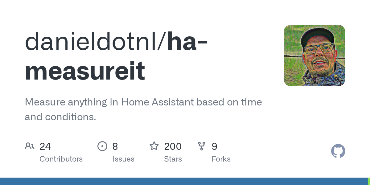

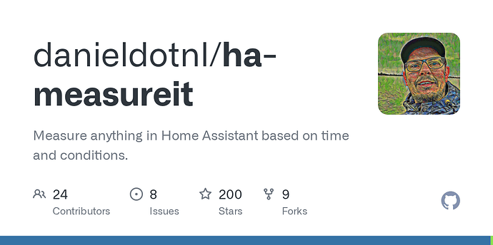

use the MeasureIt hacs component, very useful for various use cases
