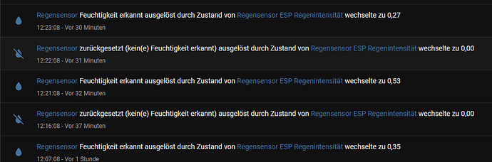

I don’t know how that works for you. It rained here this morning, but the values ​​displayed were always below 0.1. So it wouldn’t have been rain with your automation.

I have created a template and as soon as the rain sensitivity is over 0.1mm it is raining
@JulianDH do you really mean 0,1mm ? I had a day light rain with 0,01mm.
Which update intervall do you have ?
Indeed 0.1mm. I have sensitivity set to 0.02mm and found that condensation would trigger it. I think it is entirely down to what the automation requires. My velux and hunter Hydrawise sensors I suspect are closer to 0.1mm but I will test over the summer. At the moment the only thing the template does is a warning conditional tile flag on my dashboard that is raining. On my to do list to investigate a bit more.
Don’t you have any problems with the midday sun? Every midday I get rain reports.
