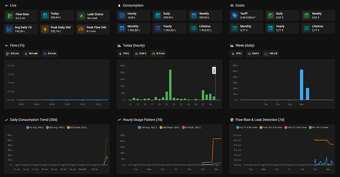

I finalized the package with all the bells & whistles. Then I created a dashboard, while waiting for the superbowl:
And in case someone needs it:
