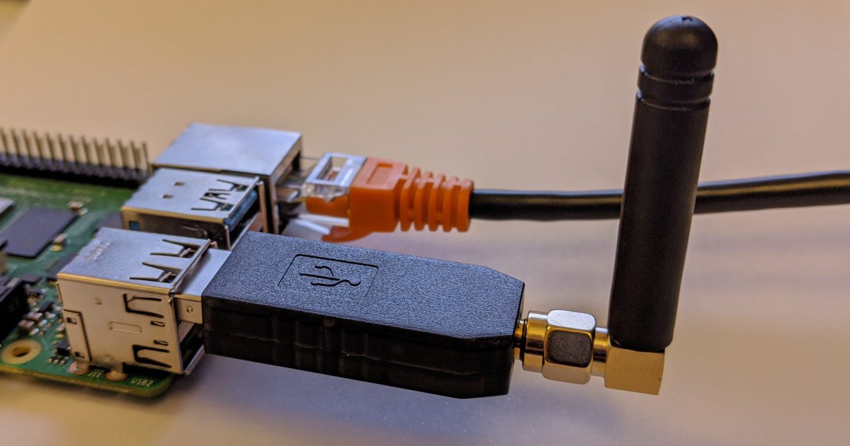

Best is to also have a better Zigbee coordinator like CC2652 with a great external antenna.
Combine CC2652, a great external antenna + mains-powered Xiaomi devices and you should be good.
