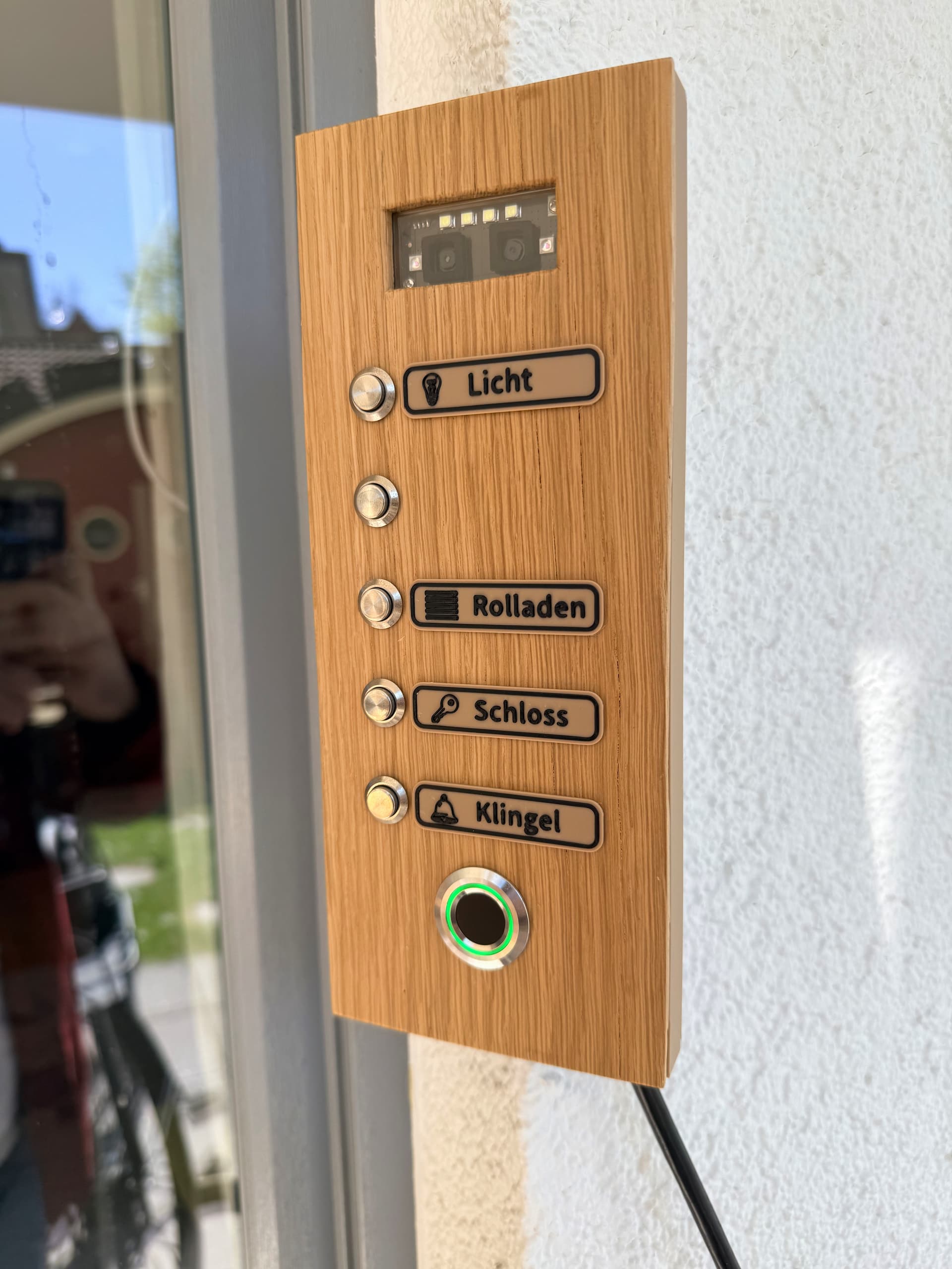

I’ve built a lot of ESPHome projects over the years, but this is by far the one I’m most proud of. I live on the ground floor and constantly use my patio door to enter my apartment, especially when coming home on my bike. I have a smart window handle from Siegenia on that door, so I needed a smart way to authorize myself from the outside.

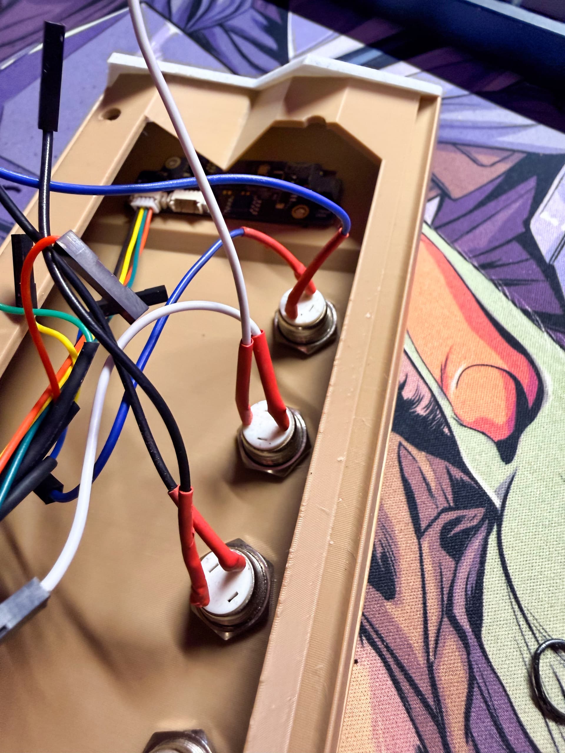

The Backstory (V1) About 1.5 years ago, I built a basic ESPHome access panel (D1 Mini, R503 fingerprint sensor, 5 buttons). Scanning my finger authorized the buttons for 20 seconds so I could unlock the door and toggle the outside lights. It worked well, but the D1 Mini’s Wi-Fi connection started getting flaky. I wanted to upgrade to a PoE ESP32, but it simply didn’t fit into my old wooden enclosure.

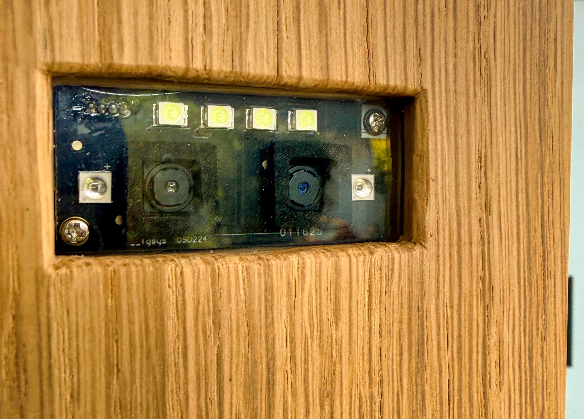

While looking for parts earlier this year, I stumbled across a Mellow Labs video featuring a DFRobot gesture sensor. To justify the high shipping costs to Germany, I browsed their site and found the SEN0677 AI Vision Sensor, which supports 3D Face Recognition and Hand Vein Recognition! I ordered it immediately.

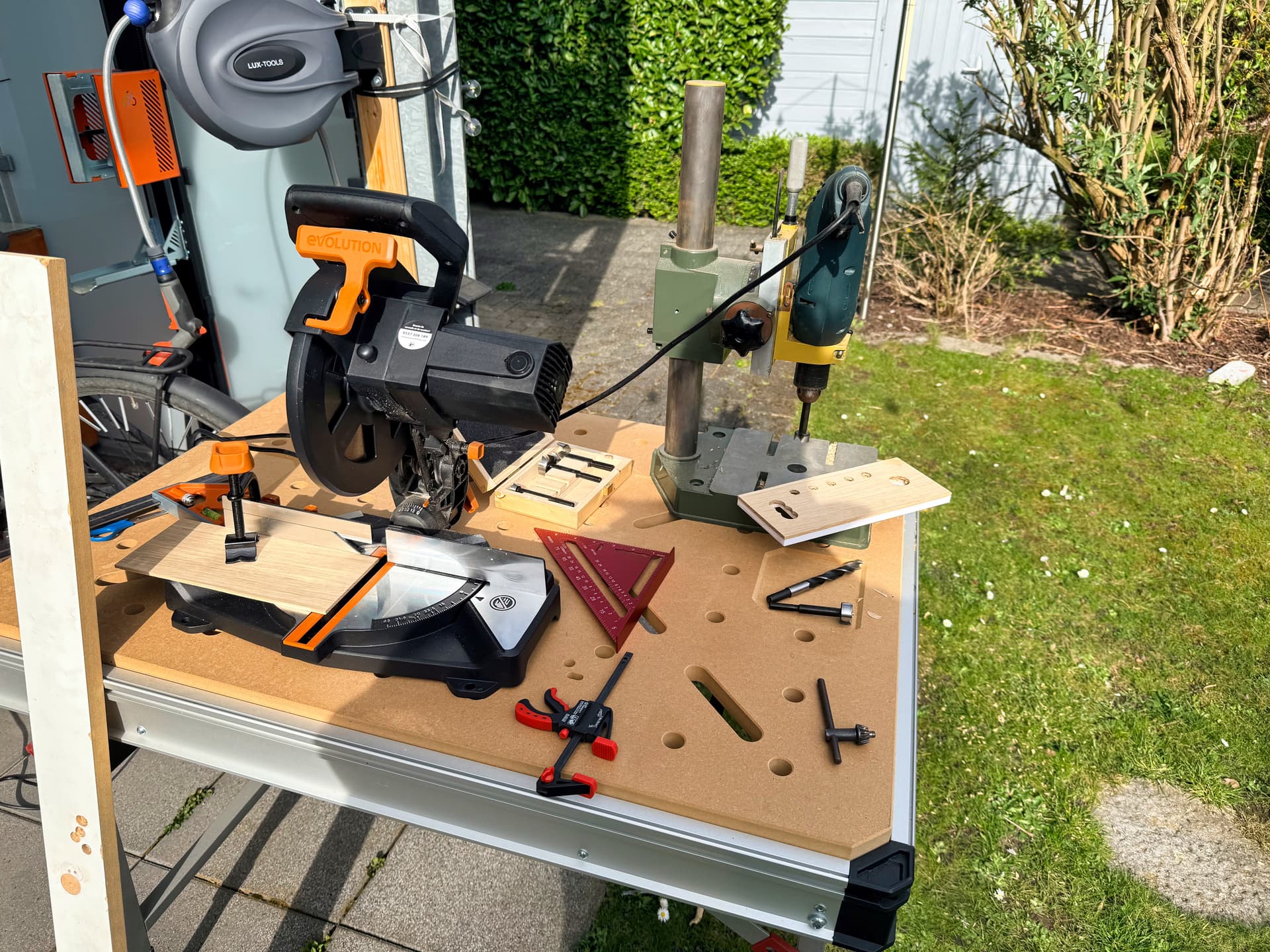

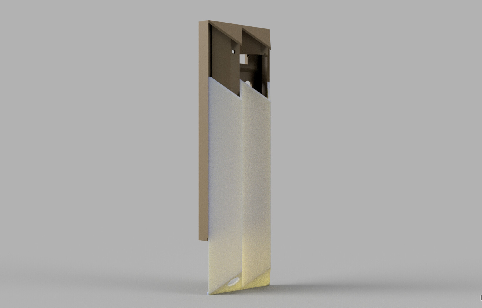

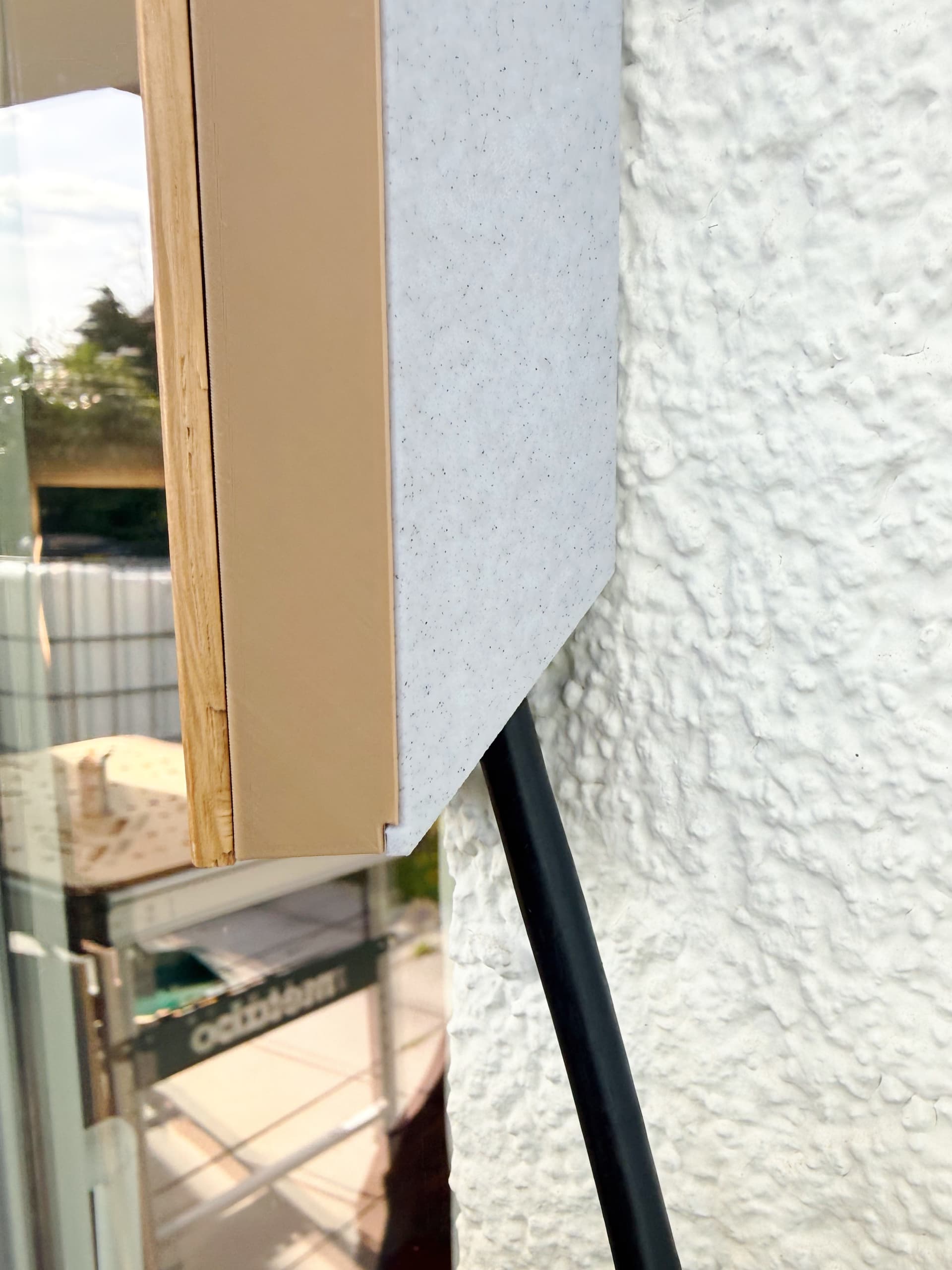

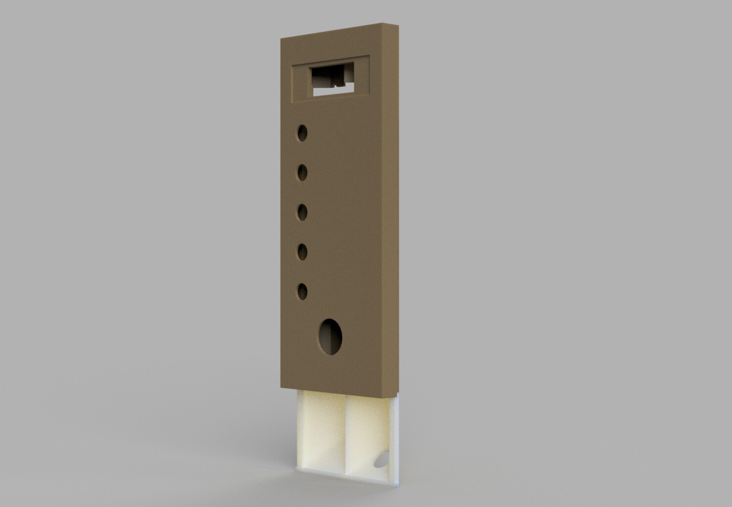

The Hardware (V2) Since I had this awesome new sensor, I designed a completely new panel from scratch:

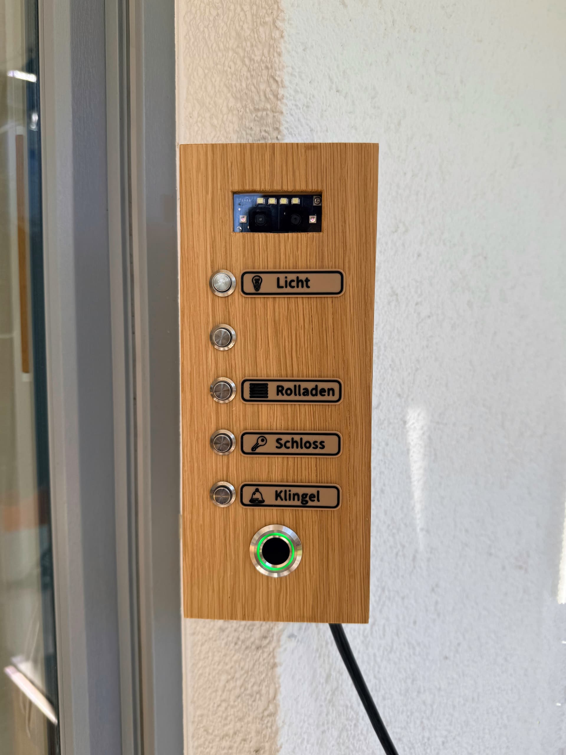

How it works in daily life (vs. SwitchBot): It works flawlessly. To save power and avoid unnecessary scans, the Face Recognition only triggers when motion is detected on the patio. Once it recognizes my face (or a valid fingerprint), the LED ring turns green, and it authorizes the local buttons to control the smart handle and the lights.
Fun fact: I actually also own a SwitchBot Ultra with the Keypad Vision, and the recognition on my custom DIY panel is significantly faster (almost instant) and generally more reliable! I can’t really speak to the hardcore security/encryption differences between the two since I don’t have the tools to test that, but I’ve been running this custom setup for a month now. I’ve had friends and family test it extensively, and so far, there have been zero false positives or hiccups.

I’m super happy with how this turned out. It’s incredibly reliable and makes getting into the house with a bike so much easier. Let me know if you have any questions about the custom component or the build!
This looks like an (expensive) OEM version of the HLK face module. You can try the built-in ESPHome integration - it might work.
Oh, good catch. I hadn’t even noticed that there’s a similar sensor with ESP-Home support. The sensors do look very similar, but the HLK-FM223 doesn’t mention hand vein recognition or QR code recognition. The board also looks a bit different. That said, the price difference is significant. Well, my component works fine for me so far, but when I update my Reddit post, I’ll definitely mention the cheaper sensor—not everyone needs to fall into the cost trap :slight_smile:
Yeah, it’s just a face module AFAIK, nothing else. Are you using those features?
