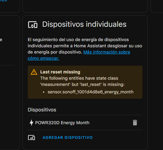

I am trying to integrate a sonoff pow elite and it shows me this error. Does this mean that it is not compatible?
