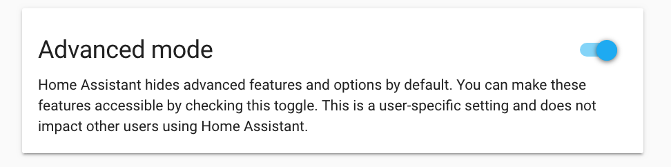

In your profile you need to enable advanced mode.

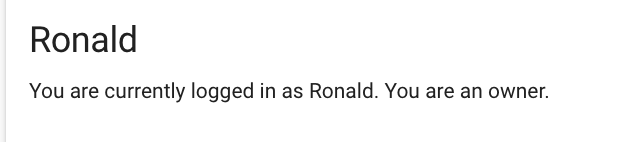

I don’t think so… You’re in the configuration panel? If advanced mode is enabled it’s right where it always was… I assume the user needs to be an owner/administrator

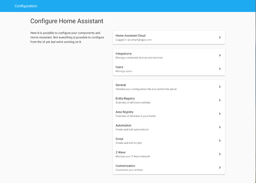

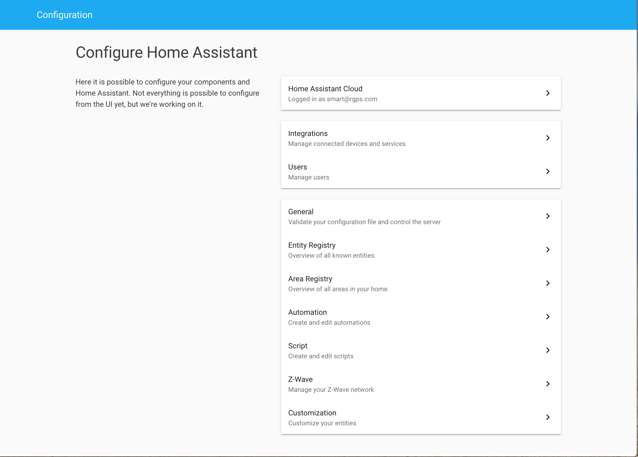

After you enable “Advanced mode” it will be located under “Configuration” -> “General” (same place as before)
You were nearly there! Click on General in the last screen shot you have there and you should see it along with the familiar configuration validation, and restart stuff.
Thanks. I looked there and everywhere else before I turned on advanced. Then I seem to have missed looking there again. Haha. Thanks for the help folks.

turn on advanced mode in your user profile and the go back to the general page and it will be there again.
