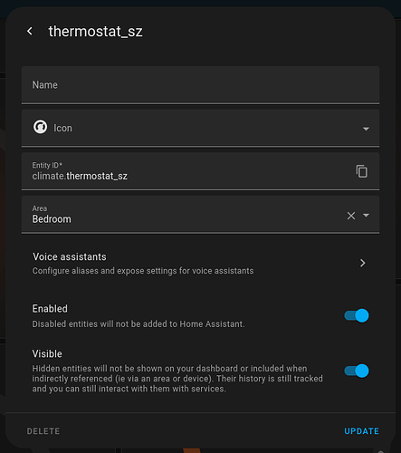

But there is an issue with the ‘generic thermostat’ thermostat cards, as they don’t seem to be connected to the thermostat entities at all. They don’t show the correct current set temperature, and when I change the temperature, no event is triggered (at least not shown in the logs). And the physical thermostats don’t react.
Does anyone have an idea what could be the cause of the problem? I have added a screenshot of one of the ‘generic thermostat’ thermostat cards.
