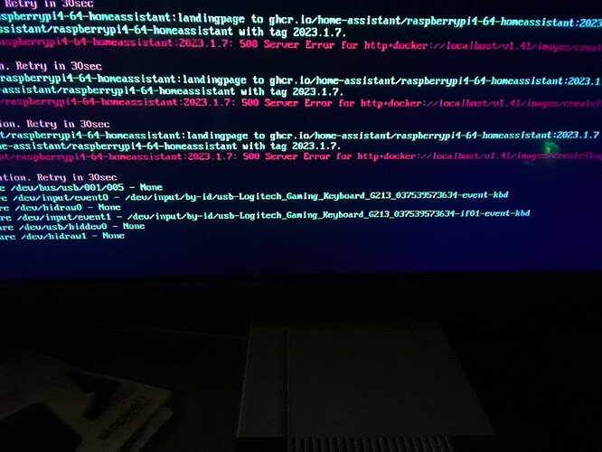

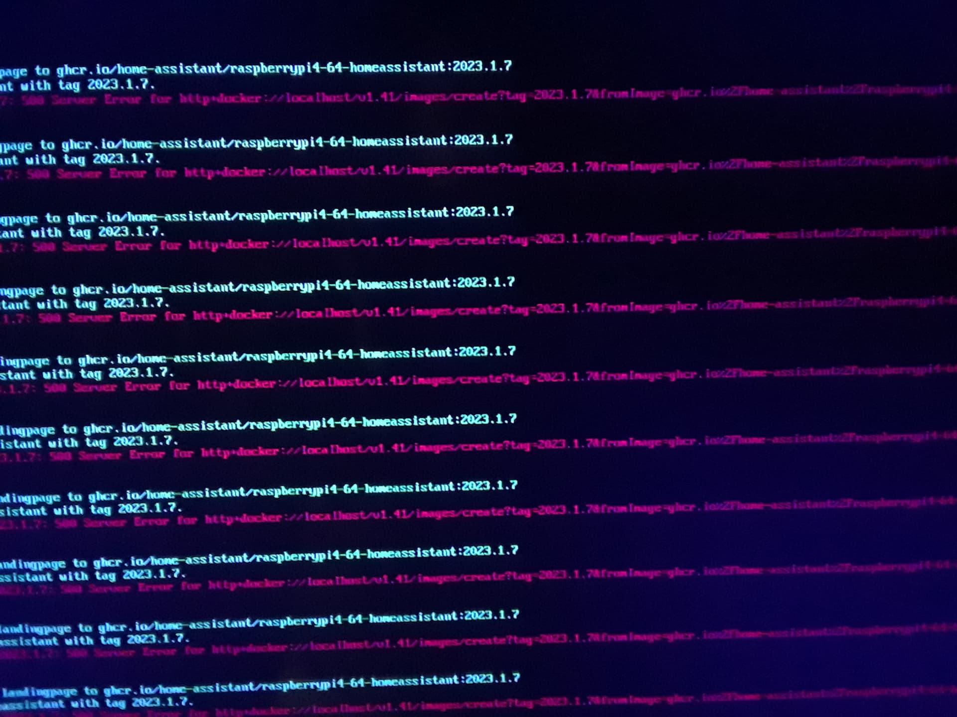

error: update of supervisor failed: cant install gbcr… 500 server error…
i tried
ha supervisor install
and it gave a list of things
so i not sure what to look for etc

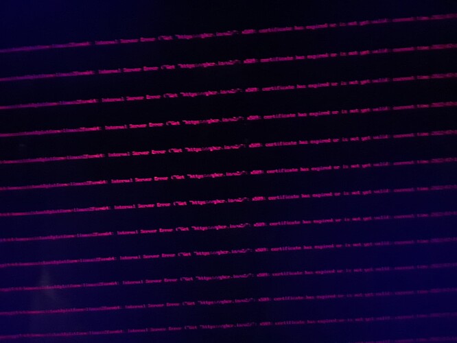

gbcr.io/home-assistant/aarch64-hassio-supervisor:2023.01.1: 500 server error for http+docker//localhost/v1.41/images/create?tag=2023.01.1&fromimage=gbcr.io%2fhome-assistant%2faarch64-hassio-supervsior&platform=linux%2Farm64: internal server error (“get “https://gbcr.io/v2/”: x509: cerficate has expired or is not yet valid: current time 2022-07-14100:45:002 is before 2022-07-i9t00:00:002”)

sorry, clueless… can’t find any relevant reference to gbcr.io in ha’s code:

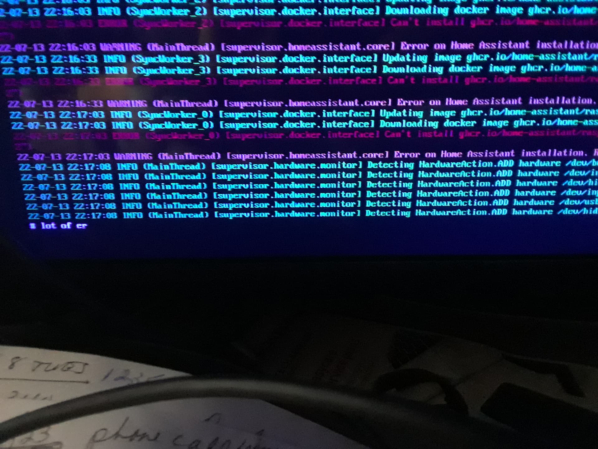

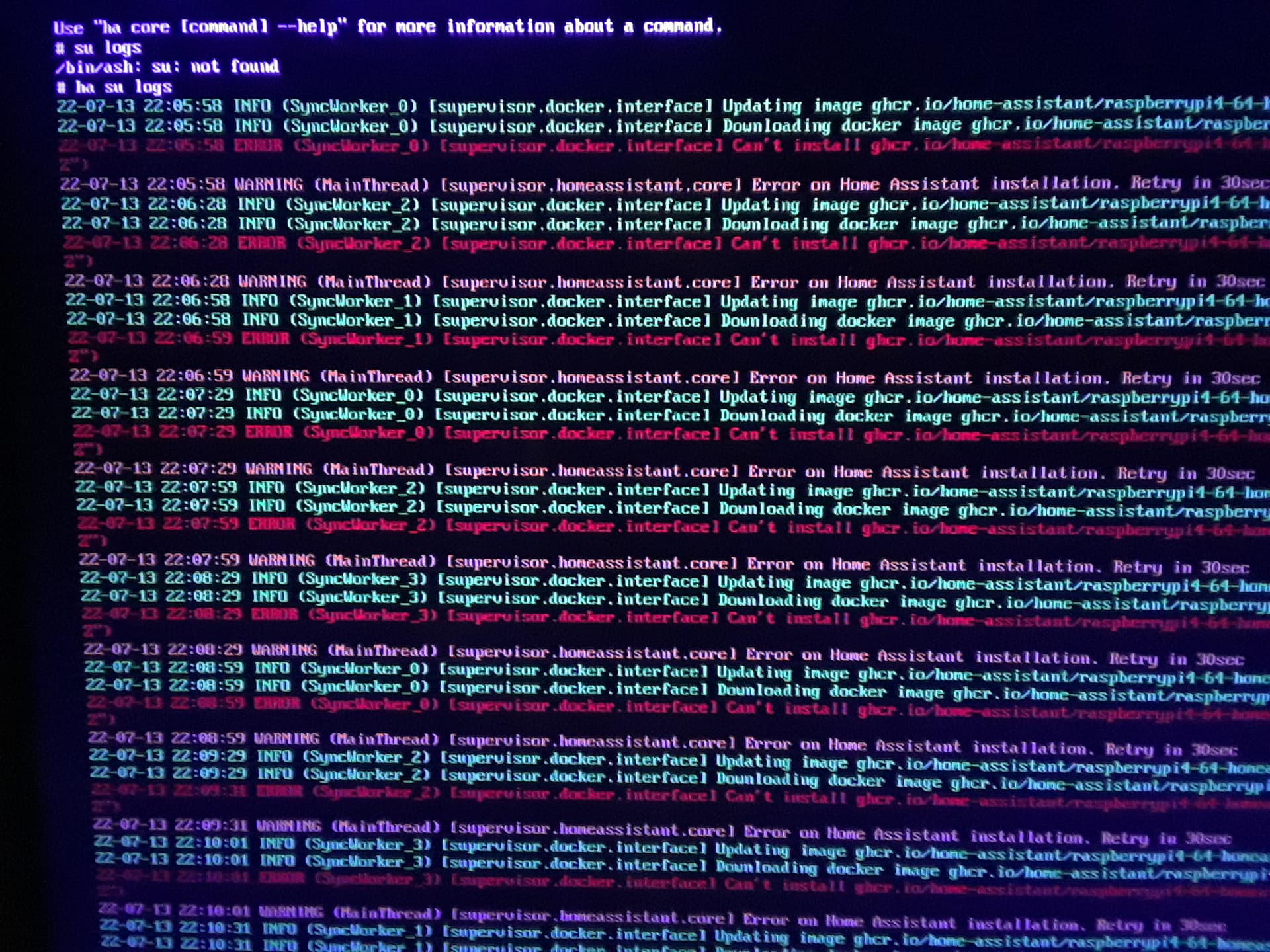

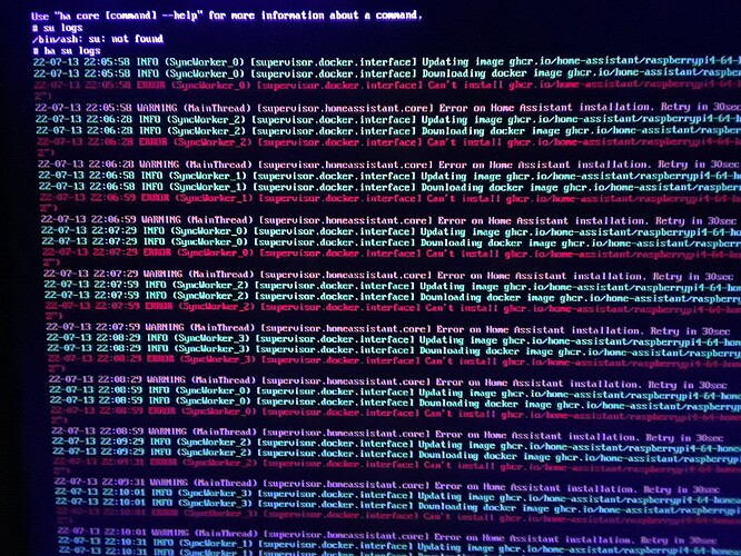

in the ha discord they type me to type
ha su logs
i couldnt upload pics there but here are some screen shots from my cell
so i typed

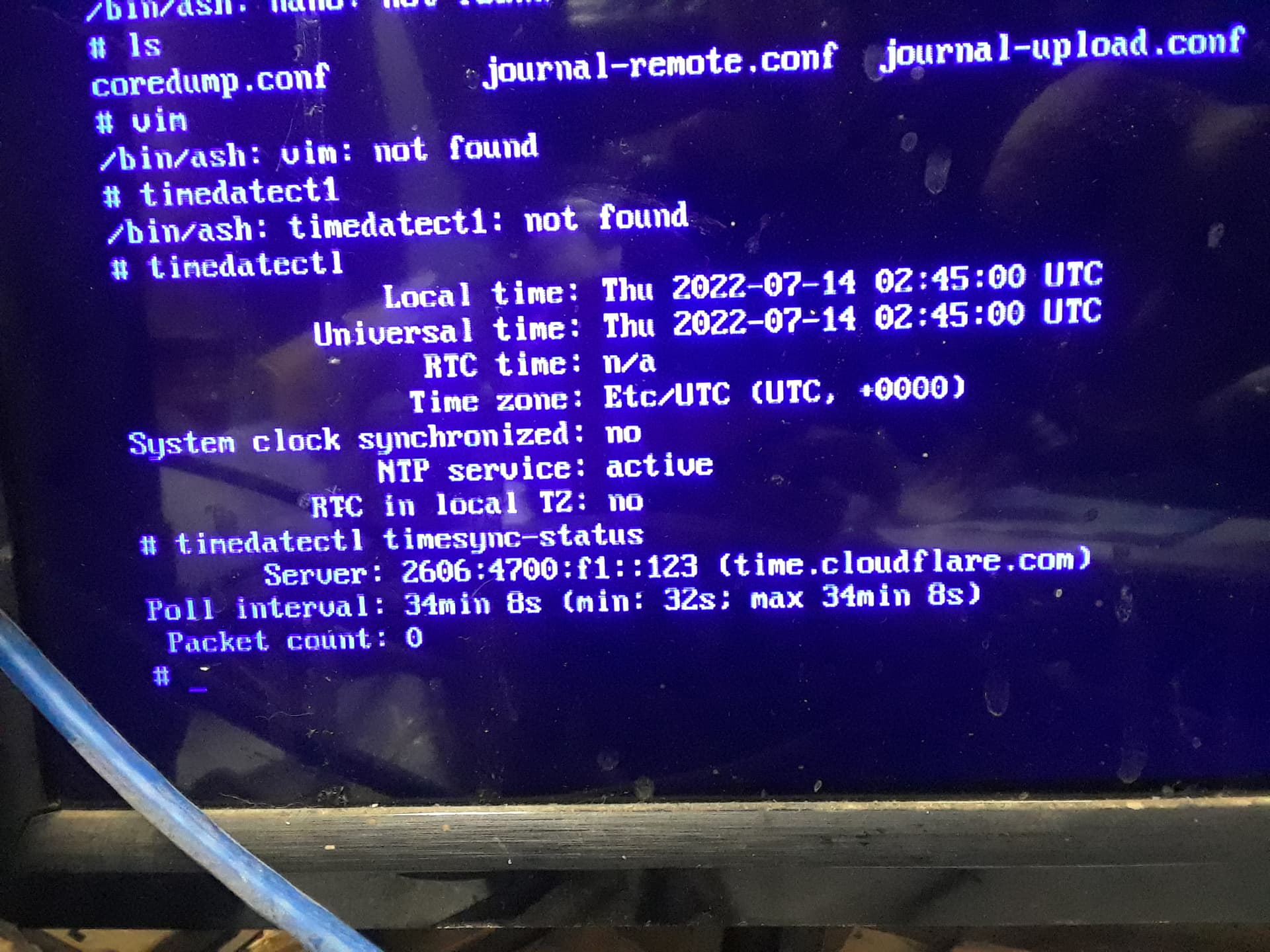

timedetectl and timedetectl timesync-status and here the screen shots and i tried pinging time.cloudfare.com it doesnt work on any computer

cant get this damn thing installed… and i cant seee any problems for ntp…

Hello guys, I’ve been facing extremely slow setup times as well.
Turns out ghcr.io has been excruciatingly slow for me. You can verify if that’s the case by checking what is being downloaded on logs using ha-cli: su logs, followed by manually pulling the docker image.
I’ve found the downloading of image slow - despite my 900Mbps up and downlinks. Everything else seemed fine tho, didn’t get any errors whatsoever as per screenshots above.
