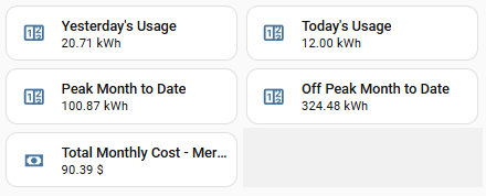

This is what I have to show the cost of electricity:
To get to this point, you need a couple of things:
1: Consumption Data - the tracked in the Fuse Cabinet
2: Utility Meter Helper - HA Dashboard → Setting → Devices & Services → Helper → Create helper → Utility meter. You will need to setup 2 Tariffs - for Peak (0.90 NOK/kWh) and Off-Peak (0.80 NOK/kWh)
3: The Utility helper will then provide the sensors that shows the consumption for Peak and Off-Peak that you can use to calculate the costs.

Mine is very basic, it is just tile cards grouped together in the dashboard.
Focus in one of them, this is just a card showing the power - peak period (energy) consumption for the month to date
type: tile
entity: sensor.whole_house_monthly_peak
name: Peak Month to Date
vertical: false
hide_state: false
show_entity_picture: false
features_position: bottom
This data comes from the Utility Meter Helper with the two tariffs - Peal and Off-Peak
