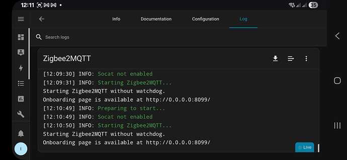

I have done all the process to connect my dongle zigbee -e to home assistant but in logs of zigbee2mqtt in home assistant i am not getting the correct logs
the logs i am having are
Zigbee2mqtt is starting…
Onboarding logs are given in 0.0.0.0:8123

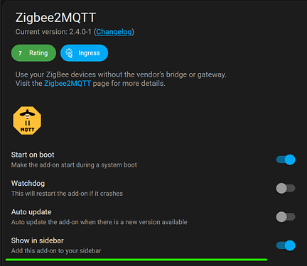

also can you explain me the point 3 with some detail; like when I install the z2m, i start the show in sidebar and watchdog button

Step 3 just assures easy access to the onboarding page once Z2M is running, but still requires you to fill in the Z2M data.

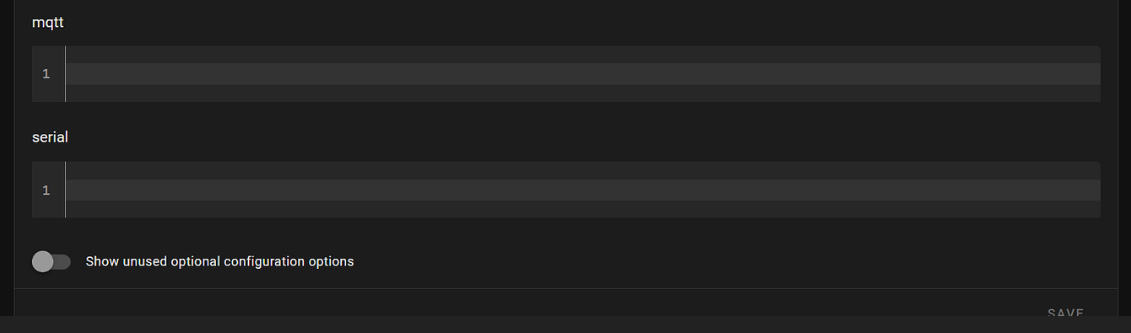

take a look of this; the configurations and the logs
if i set the mqtt and serial fields clear in z2m config it do not accept it and reset the fields to data written before
Did you see my questions?
From your logs, Z2M has started and wants you to go to the onboarding page.
clear those fields again and hit save, if the SAVE button is still colored(not gray) hit save again.
From what I have experienced, data in those fields will conflict with Z2M’s onboarding process.
yes, its done Thank for your help really appreciated
