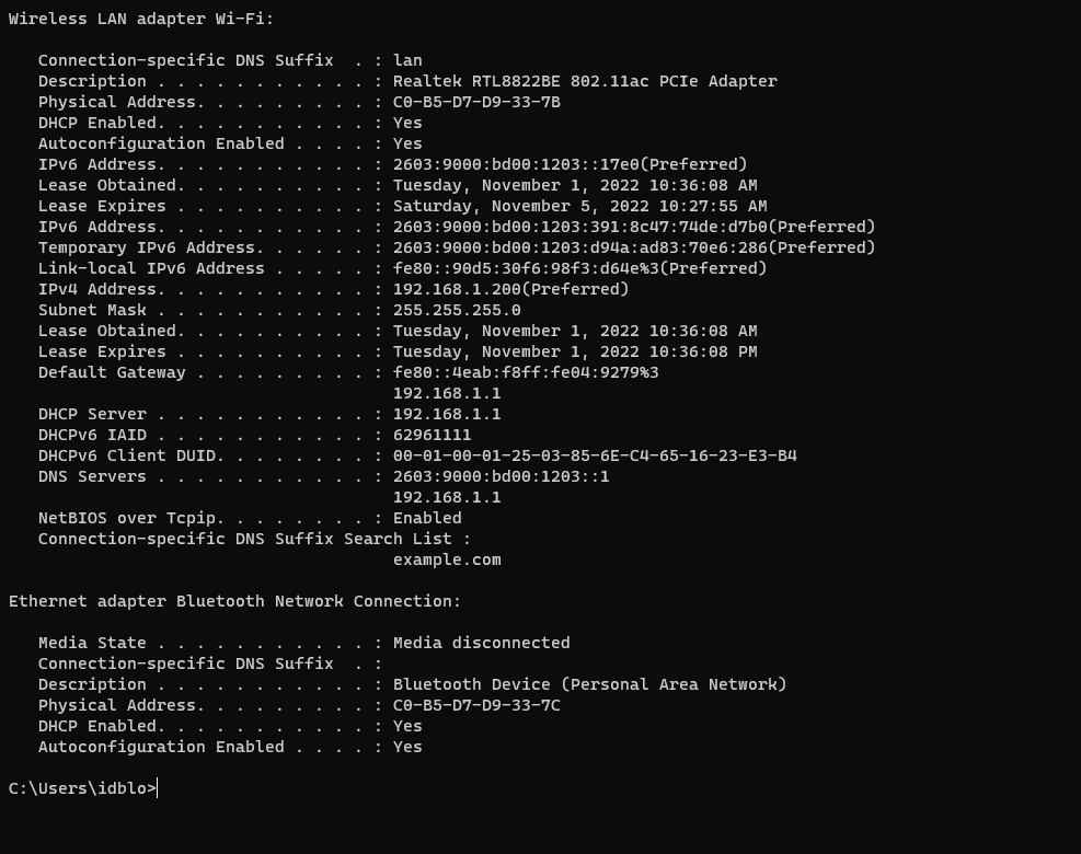

This is what I get
eth0 does not have an ip address. Are you sure it is plugged in to your network? That all cables are OK?
The RPi have to leds at the network cable connector.
When the RPi is powered on, then these should light up. One of them might be blinking, but there should be active still.
If you have no lights, then your connection between the switch/router and your RPi is not working and we are down to hardware fault then, which means cable or network card inside the RPi.
