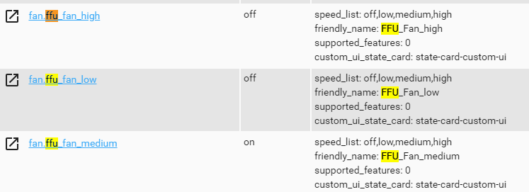

I made a fan controller with tasmota. How can I show it in Hass as a fan?
I think your two options are
or if you need to define separate entites
I use tasmota, and every output is on and off. I don’t know how to solve this problem.
I think you need to describe how your fan works before anyone can help.

What fan controller are you using?
Is it a standard Sonoff Fan controller (iFan02) or did you cobble one together DIY?
