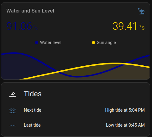

I made an improved NOAA Tides sensor for my family's summer house

I loved “old school” tide clocks. An old school tide clock is just a dial that shows the tide level on an analog clock face. Like this one I made using the Home Assistant NOAA Tide sensor and ESPHome.
All I did want come up with a percentage and map it to the clock face. I realize the time between high tide and low tide is not exactly 6 hours but this dial helps to quickly visualize where we are in the tide cycle.
This is the changes I needed
I need the “last tide” level and time and also the “next tide” level and time to build this display. Then I need the percentage between the last and next. Non of this was available in the original NOAA plugin.

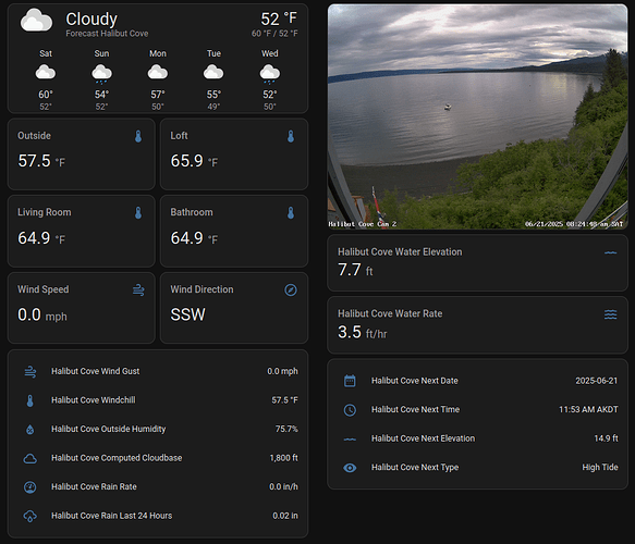

So I am going a different route…I’ve have used xtide since about 15 years ago, and know that the info I want can be generated by this program…Just spent about 10 minutes asking my favorite ai to write me a python program that periodically runs xtide to produce the next high/low tide predicted time and elevation AND the computed current water elevation AND the current rate of water level change - and publishing this information to a MQTT broker…Asked the ai to refine the program 4 times…and the total time I spent doing this was about 10 minutes…And it is trivial to get this MQTT data into home assistant in the form of sensors…
Nice! any chance you want to post that code someplace?
Hi Andrew,
Sorry about not responding sooner, but I was on an extended vacation trip until recently…yes, I just posted the code to git: GitHub - Area4949/tide_curr_2mqtt: Python scripts for publishing tide data created from xtide (https://flaterco.com/xtide/) to mqtt broker
Edit: Here’s the wxtide generated info applied to a dashboard.
