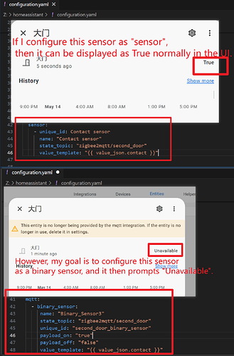

I set up the zigbee device as a binary sensor, but it prompts "unavailable". Please help me check where the setting is wrong
I usually control the lights in my home using zigbee2mqtt and Node-RED, and they work fine. Now I want to display MQTT devices in Home Assistant. If I set it as a “sensor,” it works normally, but I want to set it as a “binary sensor,” and it shows an error. I have carefully read the instructions, but I still don’t know which parameter is set incorrectly. I have already downloaded the diagnostics, and I found that the payload can display normally: contact: true. It seems that MQTT can recognize this sensor normally, but I don’t know why it shows as unavailable.
I’m a beginner, please help me take a look.
Incorrect binary sensor configuration below
mqtt:
  - binary_sensor:
     state_topic: "zigbee2mqtt/second_door"
     unique_id: "second_door_binary_sensor"
     payload_on: "true"
     payload_off: "false"
     value_template: "{{ value_json.contact }}"
If I set it as a binary sensor, the log can also normally recognize the device’s contact state as true, but it will prompt the entity as unavailable.

Sorry, I screenshotted the wrong entity earlier. It should be this one, and the status should be Unknown, not Unavailable.
I changed your code, but it’s still showing as Unknown.

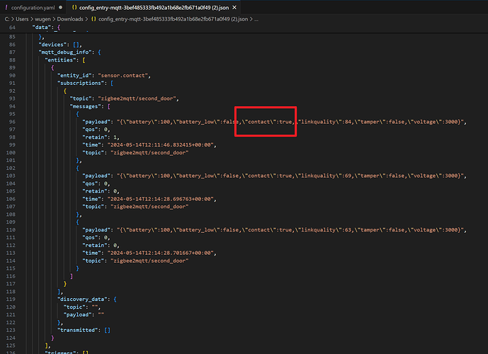

Here is the partial content of the diagnostics below, please take a look.
    "devices": [],
    "mqtt_debug_info": {
      "entities": [
          "entity_id": "sensor.contact",
          "subscriptions": [
              "topic": "zigbee2mqtt/second_door",
              "messages": [
                  "payload": "{\"battery\":100,\"battery_low\":false,\"contact\":true,\"linkquality\":84,\"tamper\":false,\"voltage\":3000}",
                  "qos": 0,
                  "retain": 1,
                  "time": "2024-05-14T12:11:46.832415+00:00",
                  "payload": "{\"battery\":100,\"battery_low\":false,\"contact\":true,\"linkquality\":69,\"tamper\":false,\"voltage\":3000}",
                  "qos": 0,
                  "retain": 0,
                  "time": "2024-05-14T12:14:28.696763+00:00",
                  "payload": "{\"battery\":100,\"battery_low\":false,\"contact\":true,\"linkquality\":63,\"tamper\":false,\"voltage\":3000}",
                  "qos": 0,
                  "retain": 0,
                  "time": "2024-05-14T12:14:28.701667+00:00",
          "discovery_data": {
