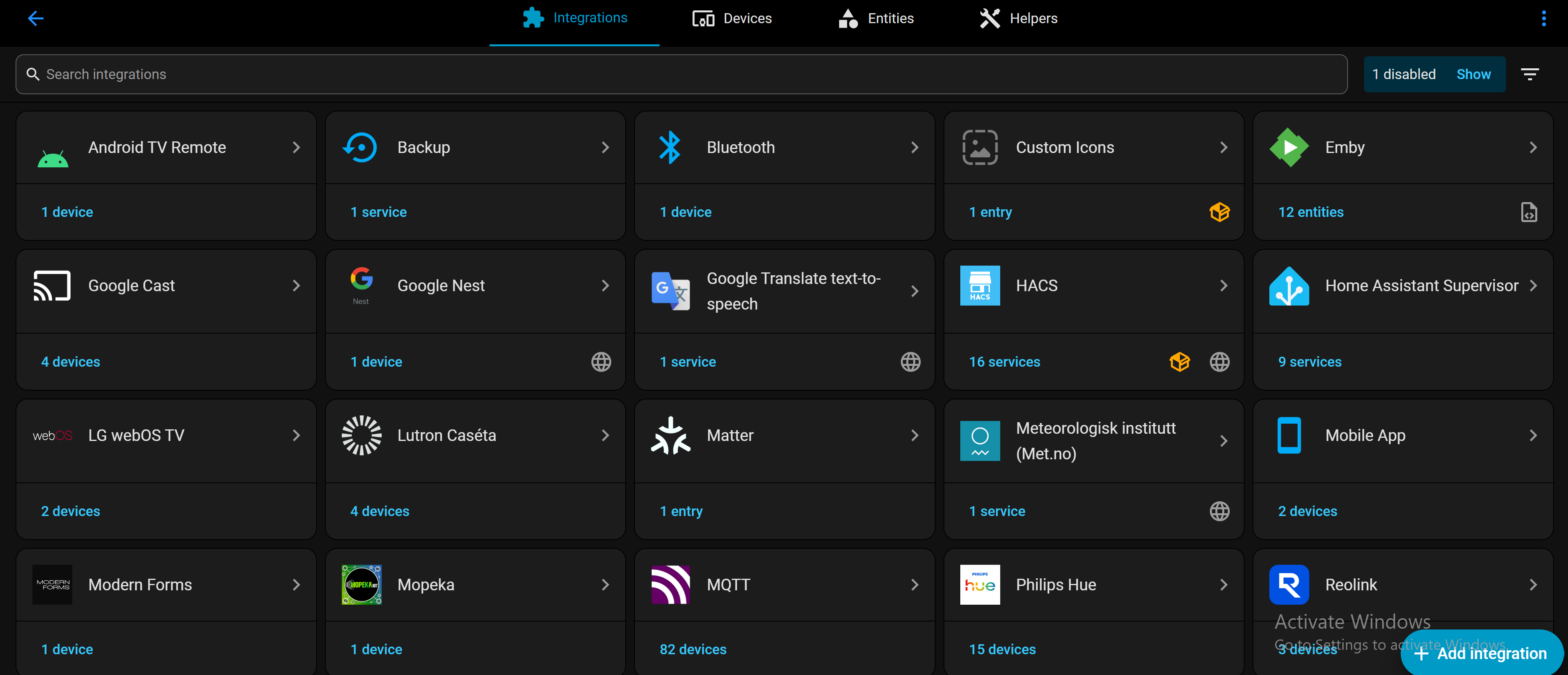

Al the icons on the intergration page (devices) were gone.
B.t.w. I love Home Assistant and thank all the people working on it. They are doing a GREAT job.
Thanks a lot.
These icons?
Yes. Exactly
Try refreshing your browser. CTRL+F5

Re the icon thing, clear your browser cache like @LiQuid_cOOled suggested.
