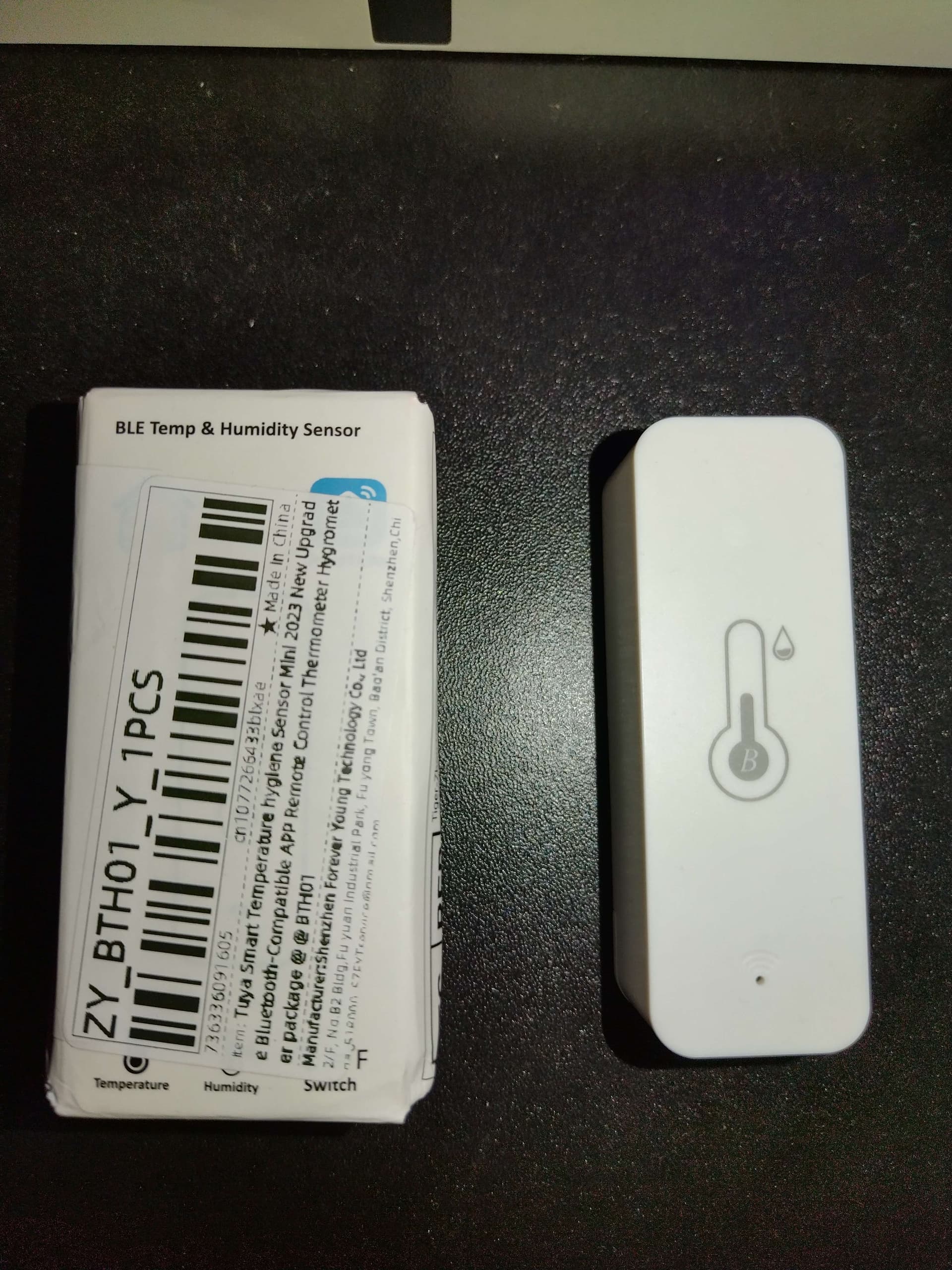

I want connect bth01y tuya temp sensor to home assistant

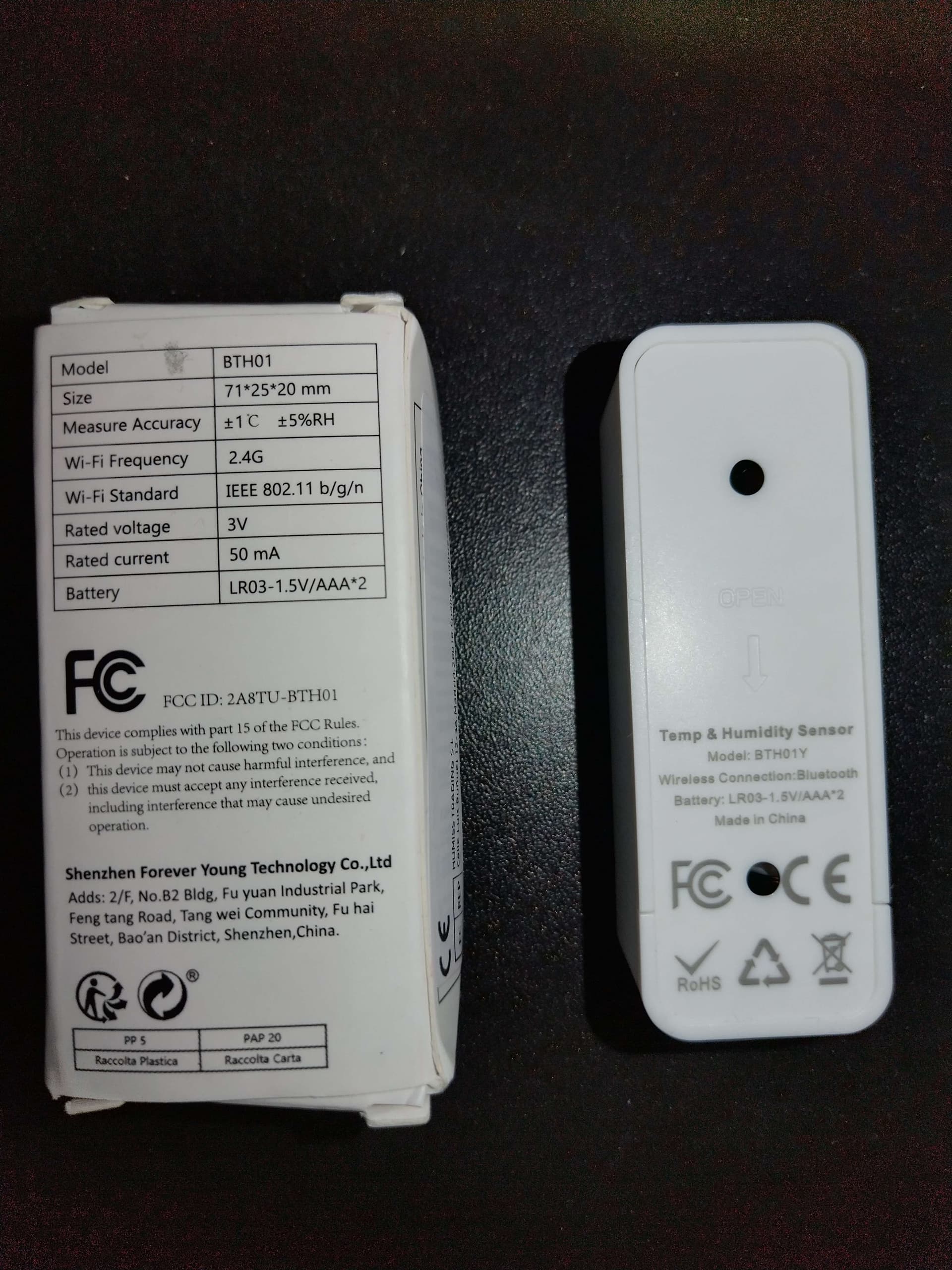

This is a Bluetooth device. I tried connecting it via Tuya Integration, but it didn’t work. Passive Bluetooth Monitor didn’t help either. How can I connect this device to Home Assistant? Please help.
I also provided photos of the packaging and the device
Do you have a Tuya multi-mode gateway (Zigbee + Bluetooth) ?
No
Tuya Integration won’t work without gateway. So your hope is to find an integration that works with a Bluetooth proxy.
I found an entry on github and would it help? GitHub - pvvx/THB2: Custom firmware for Tuya devices on the PHY622x2 chipset
Yes, you need to upload the custom firmware, and then use the BTHome integration
