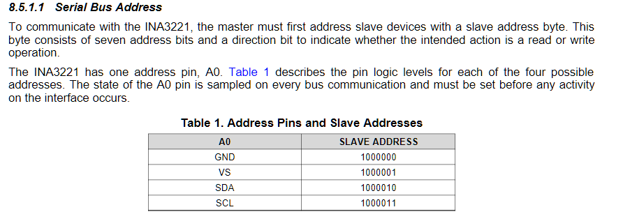

Did you leave A0 floating?
Yes, A0 is floating?
Well, it shouldn’t
Wait, im so confused. I set one of these up previously and I did not do this.
Ok, so I can short A0 to any one of those pins to address it?
Had similar experience with couple of PCF8574:
  • one device reponded on same address with all A pins floating,
  • buty another chnaged address on almost every start.
Hint for me: always connect A pins, not leave them floating - result is much more predictable.
Depending on to what you short A0, you’ll get a different (but stable) address.
It probably worked for your previous experiment by sheer luck.
Damn thanks, this is new to me, didn’t even know about this haha.
Thanks guys!
One more question, does this jumper need to remain in place for the entire time of use for the address to remain, or just once?
Thanks
Looking at the pinout, there is no A0 pin.
Damn ok sorry just found it its a jumper on the board.
