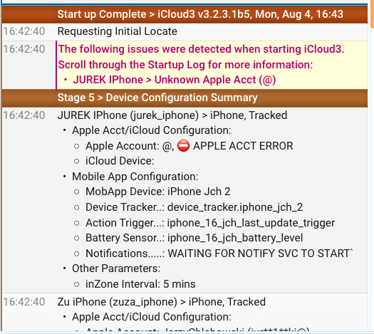

Hi, I am experiencing strange issues with my integration, I have not noticed that before but I am getting “unknown apple account” information in the log, have no clue how to overcome this, the data that show up in HA is not being updated, I have even re-installed the integration, re-added account and devices, re-requested the verification code - nothing helps… Any hint? TIA.
I think this is due to IPv6 being enabled in HA. The beta code in the issue below is trying to detect this and generate an Internet Connection Error with a message that IPv6 is not supported with instructions on disabling it.
Go here for more info, the screen that should be displayed and the beta code.

Hi Gary,
today I have copied all te files to the iCloud directory, restarted HA and unfortunately there is no change…
EDIT:
today I have finally made it run properly. Steps:
  • reinstalled iCloud integration
  • replaced files with those from zip
  • logged out from my apple account / logged in again on my iphone (it was not visible in the integration)
  • restarted integration
  • logged into my apple account
  • installed two of our iPhones to track
  • everything looks OK now…
ufff… :slight_smile:
Hope that helps anybody with similar issues - when your device is not visible in the apple account inside the integration it is worth trying to log out/log in from the device and repeat the steps above…
Thanks. J

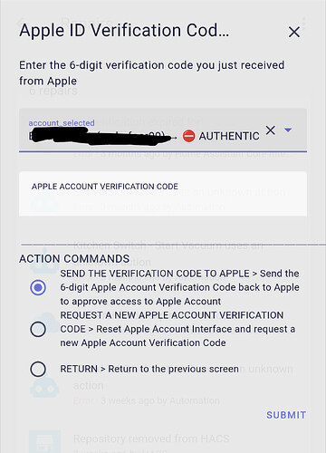

I have been using for a few months now to track an iPhone. 2 months ago I noticed an error saying the authentication has expired but it is still working. In the integration I see the option to reconfigure and if I press the error under repairs menu I get this screen
As it is still working can I just ignore it or do i need to re authenticate. I don’t want try and then something breaks as it took me a while to get it working on the first place.
Thanks
@Imygaf
Yes, Apple will continue to send data for a while but it will eventually lock the account. When it is locked, you will need to log into your account at apple.com, icloud.com or another url, unlock it and then go through the verification process.
The best thing to do is to go back to the verification code screen, request a code and then enter it.
