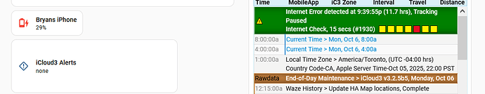

Login and verification work and everything runs fine, until I get a network error. If i restart icloud3 everything is fine again. Last night was a 14hr offline session.
Is there a way to automatically restart the plugin if there is a lengthy downtime?
@bryancowell
There is a restart option on the icloud3 action service call. See the iCloud3 docs here for info about that. Maybe you can tie that into the sensor.icloud3_alerts.
I’ll give it a go. Is there a particular alert message I should be searching for ? I’ve just set it up to notify me of the message at the moment
@bryancowell
I believe it will have the rest Internet Error detected at in the state value
It looks like there is no error text
