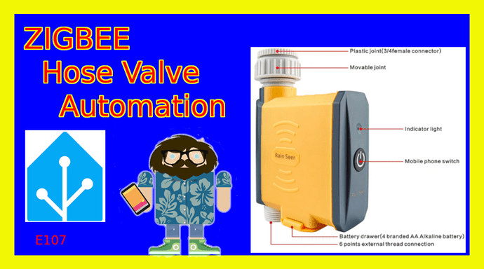

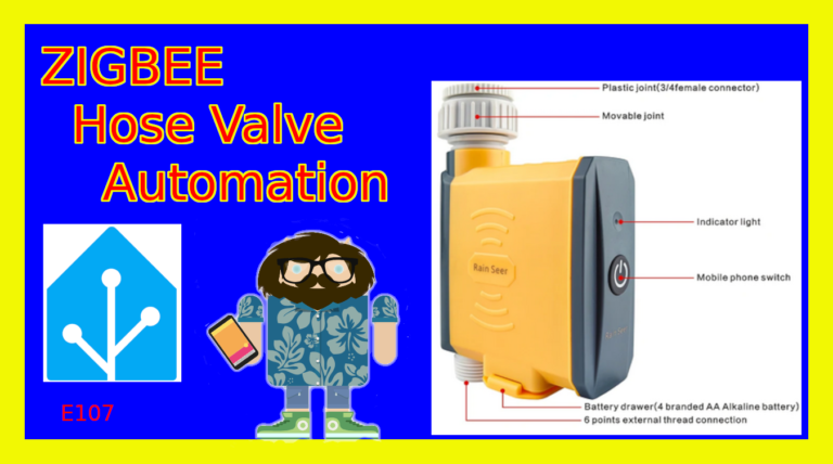

Just grab a zigbee sonoff valve and ad a soaker hose?

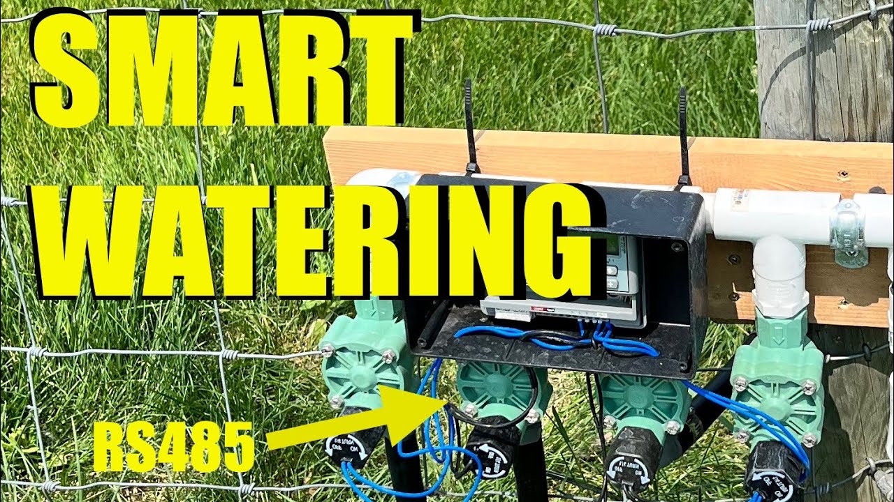

This video just came up in my feed, may be of interest to folks here:
that is a battery operated valve that ties into home assistant and my existing rachio whole yard irrigation system.
Ok, nice.
I though I replied to OP…
So how it works, what’s the communication method between valve and the hub?
I’m not sure. You put in a battery and they show up in the Rachio app and by extension in home assistant.
