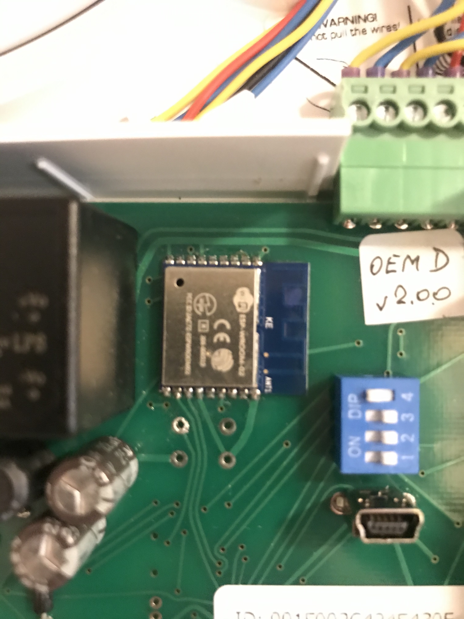

The device has an espressif esp-wroom-02 chip on it. I’ve been checking the board for accessible pins, but it’s not very tinkering friendly made.

Photo be nice mite be able to put tasmota or esp home on it
I’ve been going through the whole board with a multimeter in search for accessible RX/TX, but could not find any. I only find them in places I’m not comfortable soldering on.
This is the whole board:
Here’s a closeup on the esp-wroom-02 chip:
Another possibility would be to connect a second ESP to the input used by the control board on the side, but then I have to figure out how it works.
