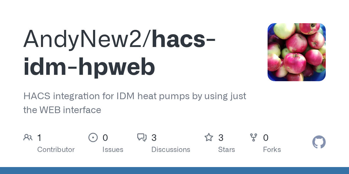

Hi, there are now two integration you can use for iDM Heatpump based on Navigator 2.0:
and
