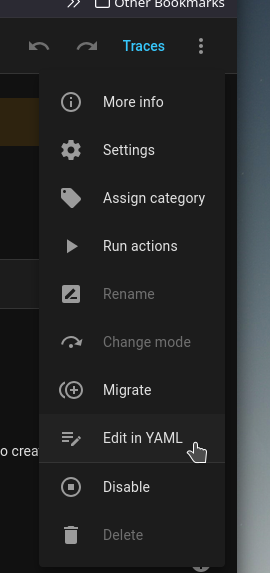

  1. 3 dots
  2. edit in yaml
  3. copy
  4. paste here using the</> key in the post editor.
How to format code or use the</> key in the post editor.

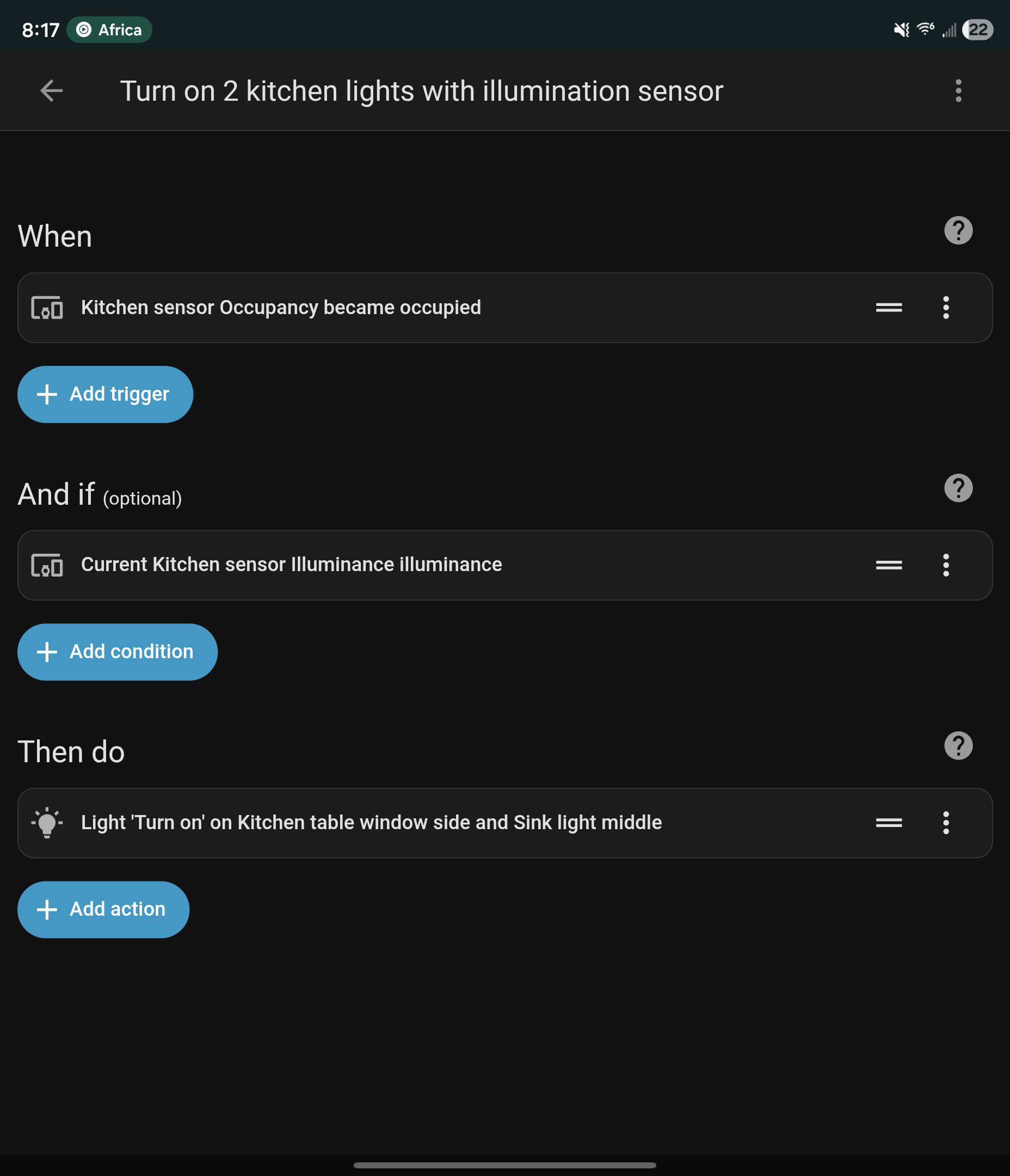

alias: Turn on 2 kitchen lights with illumination sensor
description: ""
triggers:
  - type: occupied
    device_id: b4c8a8c186555d9d74dd0fdbabb384b2
    entity_id: a52837dee39a2e5cace68917574c0611
    domain: binary_sensor
    trigger: device
conditions:
  - type: is_illuminance
    condition: device
    entity_id: a1db999db6117b12aef7ee89885da997
    domain: sensor
    below: 20
actions:
  - action: light.turn_on
    metadata: {}
      entity_id:
        - light.wiz_rgbw_tunable_0803c4
        - light.wiz_rgbw_tunable_08606c
    data: {}
mode: single

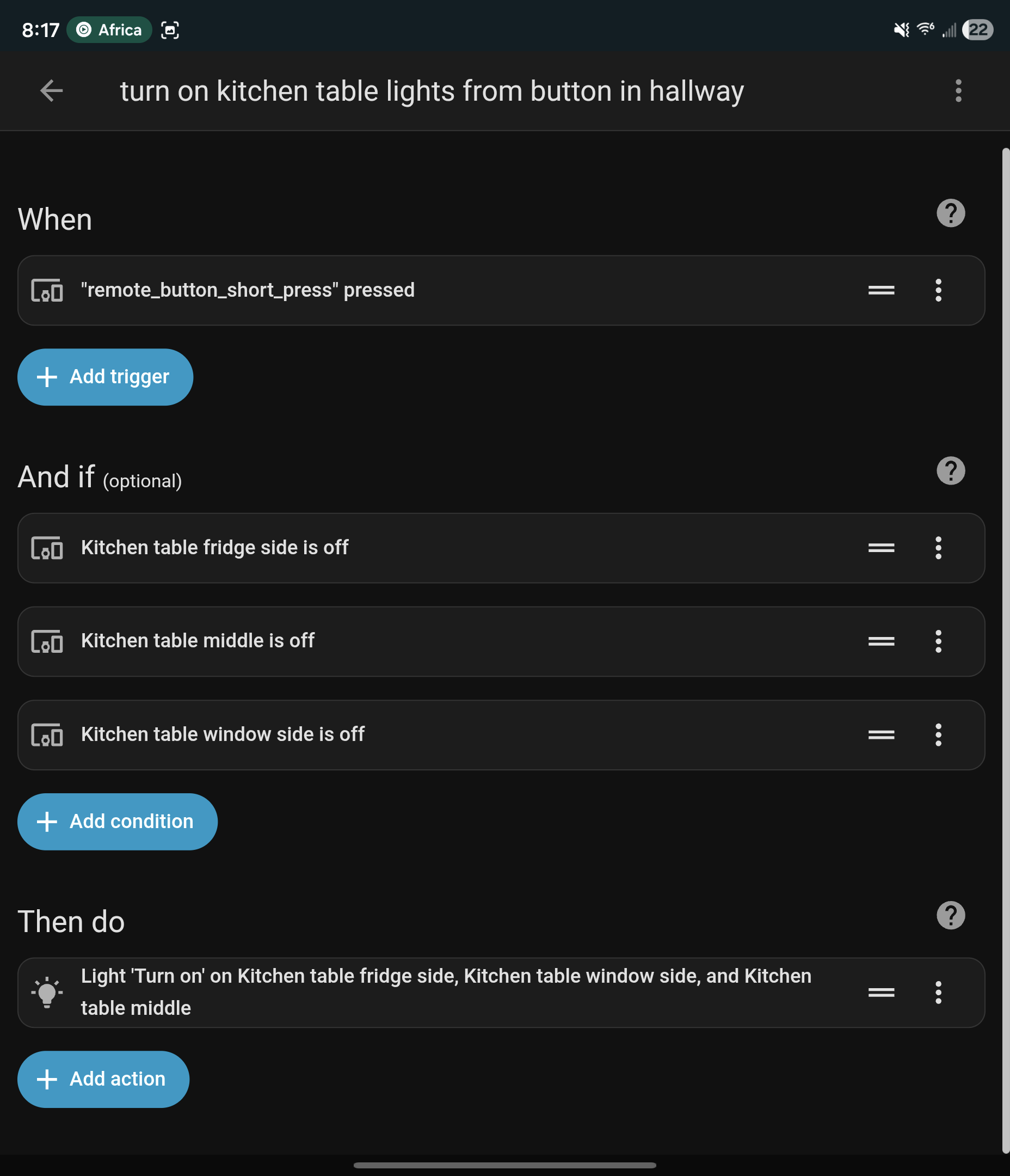

alias: turn on kitchen table lights from button in hallway
description: ""
triggers:
  - device_id: 9309025efe9d5f6a3d91325f29abaec2
    domain: zha
    type: remote_button_short_press
    subtype: remote_button_short_press
    trigger: device
conditions:
  - condition: device
    type: is_off
    device_id: 787c7ce4d3c2385d05f4bdf3918dff97
    entity_id: 7178f2479bcc90e60789fde7f43df448
    domain: light
  - condition: device
    type: is_off
    device_id: e0400560b602e2482f19a2e24ee7ec6a
    entity_id: 9da67a7d3f8bdb9a6f16a01352d74bd7
    domain: light
  - condition: device
    type: is_off
    device_id: a3a85315adf863aaba31601e5c0db050
    entity_id: 9d6ff71aab2d42b08dd8a9d7b686e775
    domain: light
actions:
    metadata: {}
      entity_id:
        - light.wiz_rgbw_tunable_07e91c
        - light.wiz_rgbw_tunable_07c2b6
    data: {}
mode: single
light.wiz_rgbw_tunable_0803c4 is turned on in the motion sensing automation.
And while not sure since you use device conditions, but most likely you have a condition that this light must be off since the same light is used in the action part.
So does the light have to be off or not?
The automation for the button has a condition that prevents the action to be executed when kitchen window side is on.
Just disable/remove the last condition
