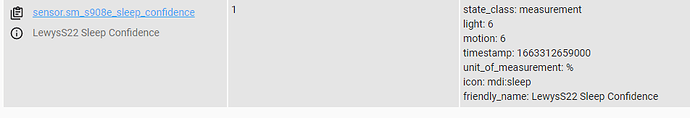

Hi guys,
Been reading around a bit but cant seem to figure out how to do this.
I have a ‘sleep confidence’ sensor from my phone, I want to create a template binary sensor, where if the sleep confidence is over 70% then the binary sensor should change to on
If under 70% then it should be off…
Is anybody able to help me out with this ?
Thank you !

Thanks both for your help!
We have a winner with:
- binary_sensor:
name: "Lewys Sleep Confident"
unique_id: 67297
delay_on: 00:02:00
delay_off: 00:00:05
device_class: occupancy
state: >
{% if states('sensor.sm_s908e_sleep_confidence') | int > 70 %}
true
{% else %}
false
{% endif %}
