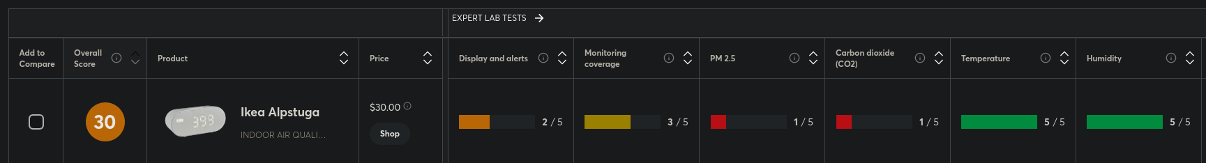

fwiw, consumer reports did a review of “Indoor Air Quality Monitors” and the Alpstuga was the worse one.
