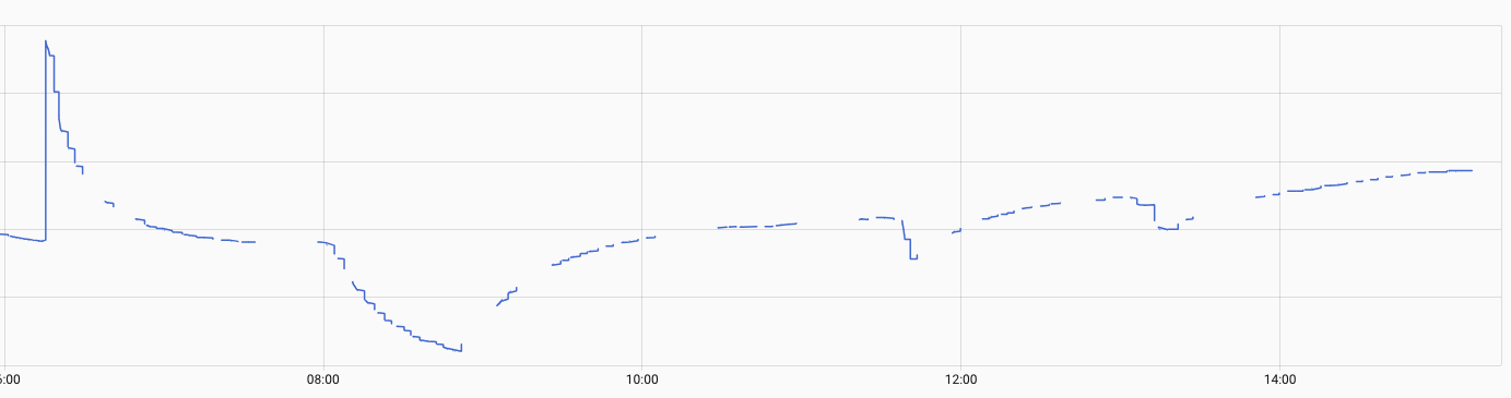

Just to illustrate the problem – before the factory reset – here is a graph of the temperature in Alpstuga yesterday where you can see the drops:
