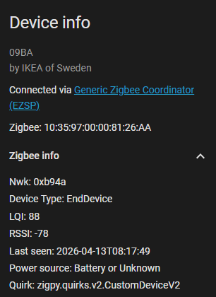

The device type for the scroll wheel is 09BA so I tried the 2 button custom quirk and just changed the device to QuirkBuilder(IKEA, "09BA") but that didn’t seem to have an effect. Still no zha_event fired.
Looking at the device page the quirk is also detected and applied:
I did some more debugging and did not see any “cluster_command” events received by ZHA for the scrollwheel so it looks like it implements only the basic battery level and connection but does not send any events via zigbee.
That means it only works over Thread.
It is dependent upon the coordinator being used. EZSP coordinators seem to ignore the events at the moment because of how IKEA implemented the Zigbee functionality.
