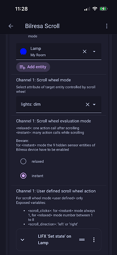

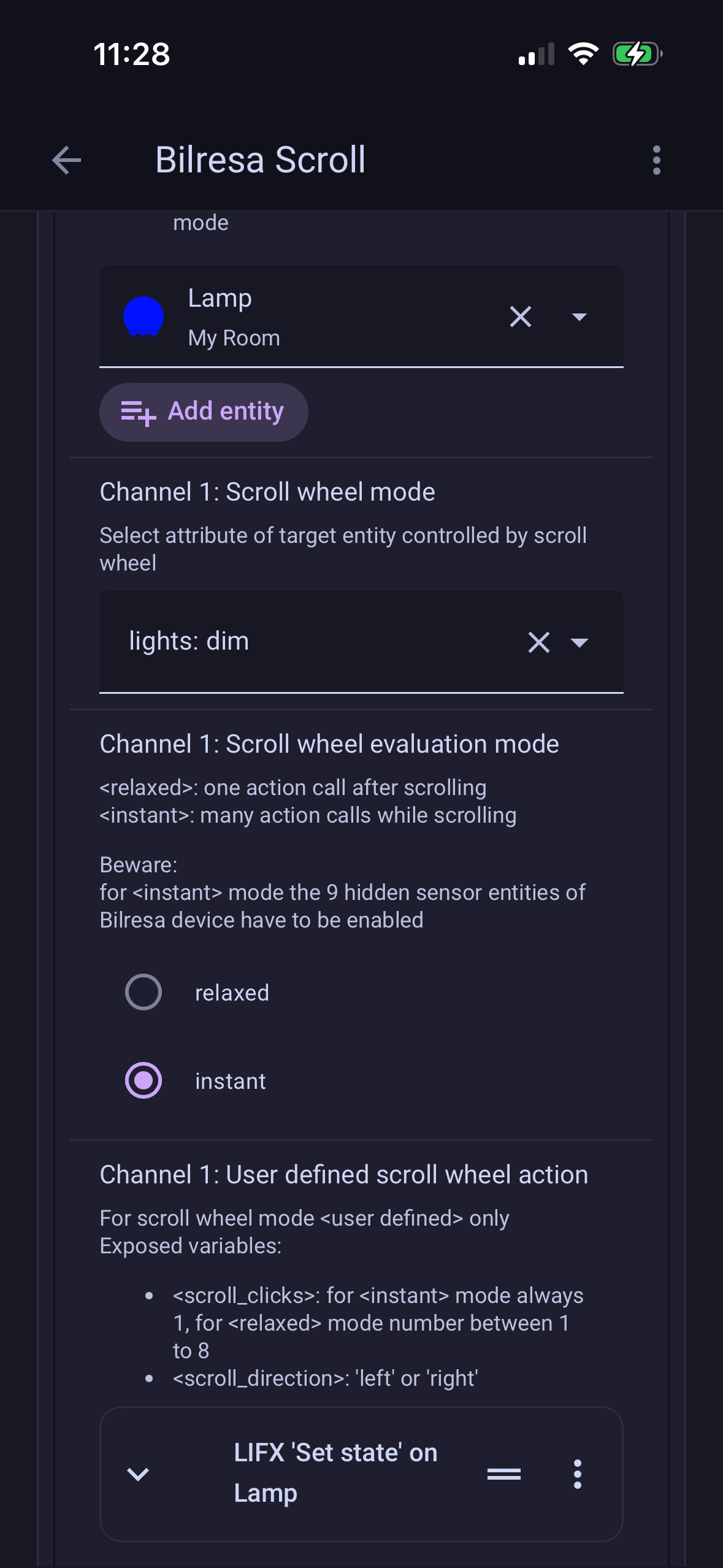

Spent forever trying to figure out how to get my scroll wheel to simply control brightness of my lamps smart bulb. This Blueprint helps.
This is what I have so far.
But how do I make do a brightness up in the reverse? Do I need a separate automation for that?
Brought these scroll wheels hoping they would act like the volume on an old iPod nano wheel.
For simple dim up/dim down only these two settings are needed
(and no user defined action)
Does the simple setting work for you?
What exactly do you want to achieve?
