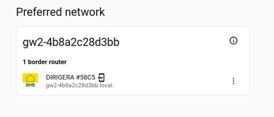

Tried another way. Removed Bilresa from Ikea App. Added ikea TBR as preffered network in HA. Added Bilresa using the HA companion App. Same result. No updates after 3 minutes and Subscription Liveness Timeout error in Matter Server.

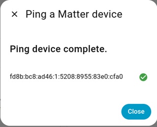

Also tried pinging the IPv6 address on Bilresa as shown in matter integration and it responds when i wake it up. Ping6 to ipv6 address of HA also responds with success.
Tried pinging Bilresa from HA. It succeeds.

I added Dirigera hub to ikea home app and added one thread sensor. This sets up thread network and adds thread credentials to Apple key chain. Then go to HA ios app settings → thread and click on Send credentials to Home Assistant button at the bottom. Now go back to setting menu and thread menu and you should see the option to make this preferred network.

It’s worth mentioning that if I pint the dirigera hub using the matter integration only the IPV4 address works
