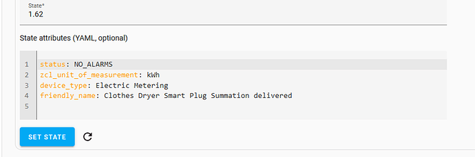

Just jumping in here to say I had exactly the same problem with a Samsung smart plug.
I went to Developer tools → States, found the entity in question, and edited the yaml.
Following a restart of HA, it picked up that the unit had changed, asked me if it should adjust the history values, and now all is working.
