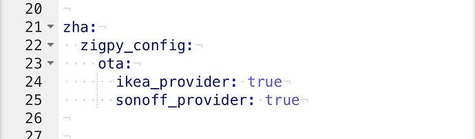

I had the same situation. After adding this code to Configuration.yaml (and waited 4 hours), it detected the new firmware and prompted to be installed.

Hi Paul,
Can you explain where I need to add the yaml code to get the firmware updated? Need some guidance here, appreciate your feedback
I use a Conbee 2 as coordinator, so guess Sonoff must be changed to Conbee.

When entering the ikea_provider: true text, I got an error saying this is an invalid entry ( using Visual Code server as editer) same as Viking experienced.
So I changed this to this:
Restarted Home Assistant and now update messages are coming in including the INSPELNING update. Did the update and now the voltage and power is correctly displayed. Firmware version is showed as 0045.
