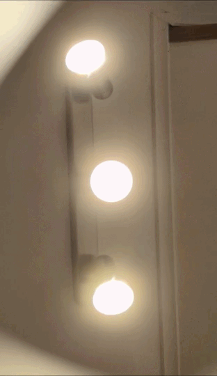

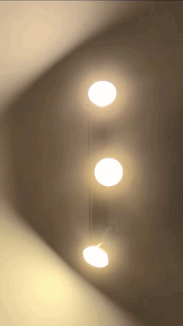

7342
7343
I have been needing to capture their behaviour for a while. Can anyone explain this?
