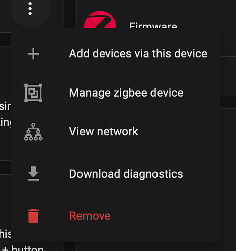

It isn’t an issue with the batteries. It’s some kind of problem between the coordinator and the Ikea products. They seem to work flawlessly if you pair them via another device. Go to the any mains-powered device which acts as a zigbee repeater, and open its information page. Where is says Reconfigure, under the three vertical dots, you will find “Add devices via this device”

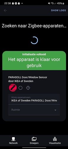

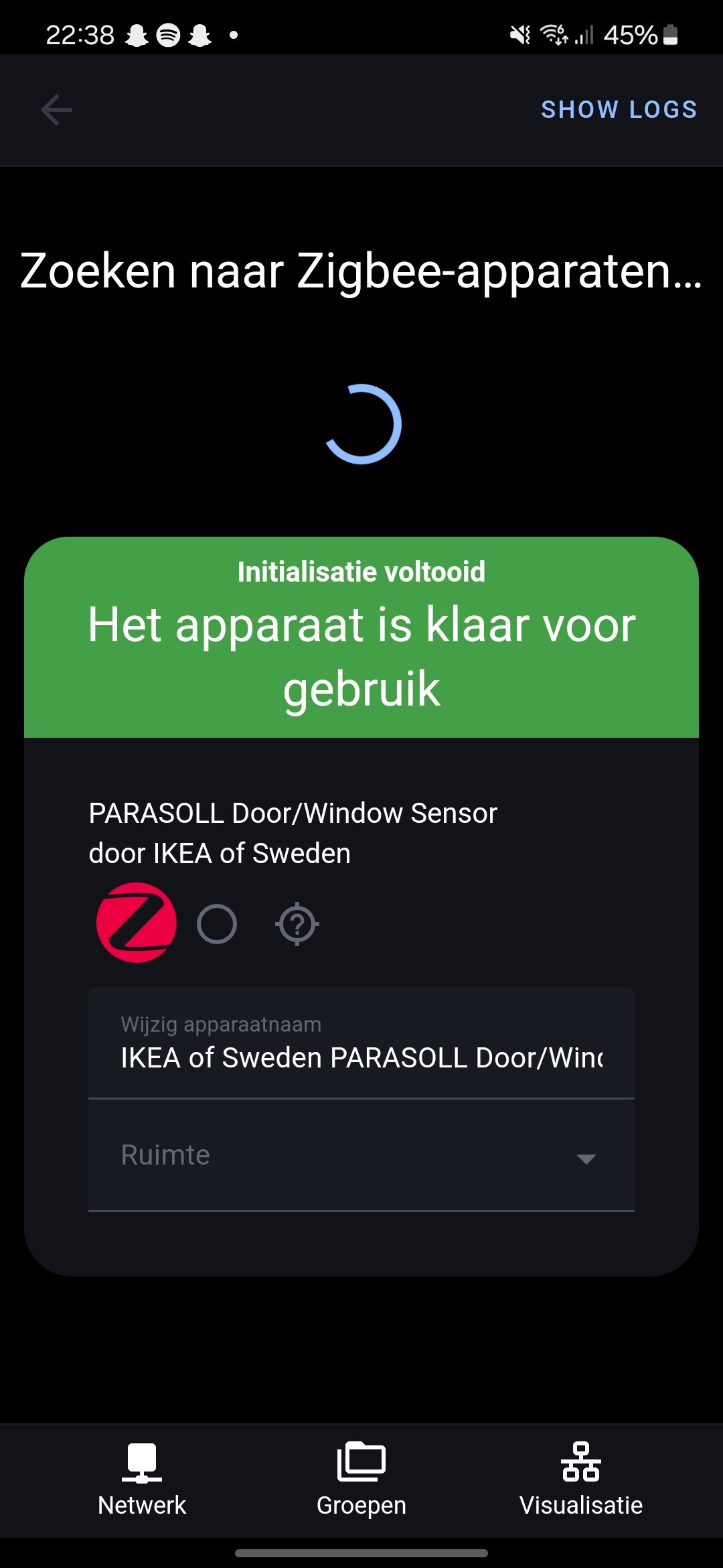

I was also stuck in the “Configing” step. When it had hung for a while, I tried rebooting Home Assistant and when everything came back online it had successfully paired (this was with ZHA)

  • In the ZHA integration, go to the devices page and click “ADD DEVICE” at the bottom right
  • On the Parasoll, click the pair button 4 times quickly, the red LED should start blinking (you don’t have to be touching a coordinator or a router or whatever, just be in the general area of something it can talk to
  • With any luck the Parasoll will show “Starting Interview” and then in a few seconds “Interview complete > Configuring”, if not, start over and go back to the devices page and do it again
  • I’ve yet to get a Parasoll to go completely through the setup process no matter what I’ve tried, so, what to do?
  • Let the Configuring run until it just stops and the “Searching for Zigbee devices…” at the top of the page is replaced with “SEARCH AGAIN”, this will take a few minutes
  • Now click the back arrow twice to go back to the ZHA integration page
  • Click the three dots under Integration Entries > Configure and click Reload, this will reload the ZHA integration
  • With any luck, despite not “correctly” completing the pairing process, the Parasoll will show up in the list of devices and should work

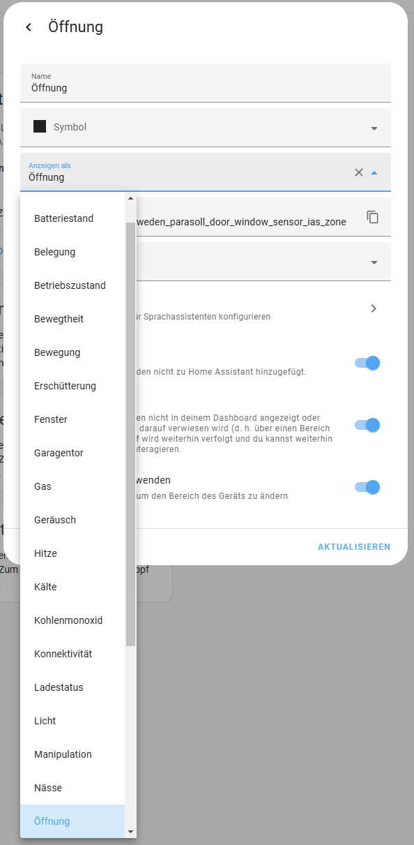

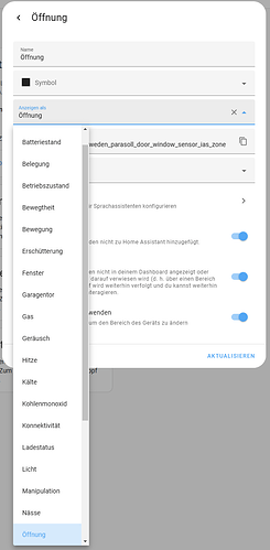

One of two of mine also showed “IAS Zone”, but I simply went into the config of the sensor, and selected a different “show as” (“Öffnung” is German for “open”):

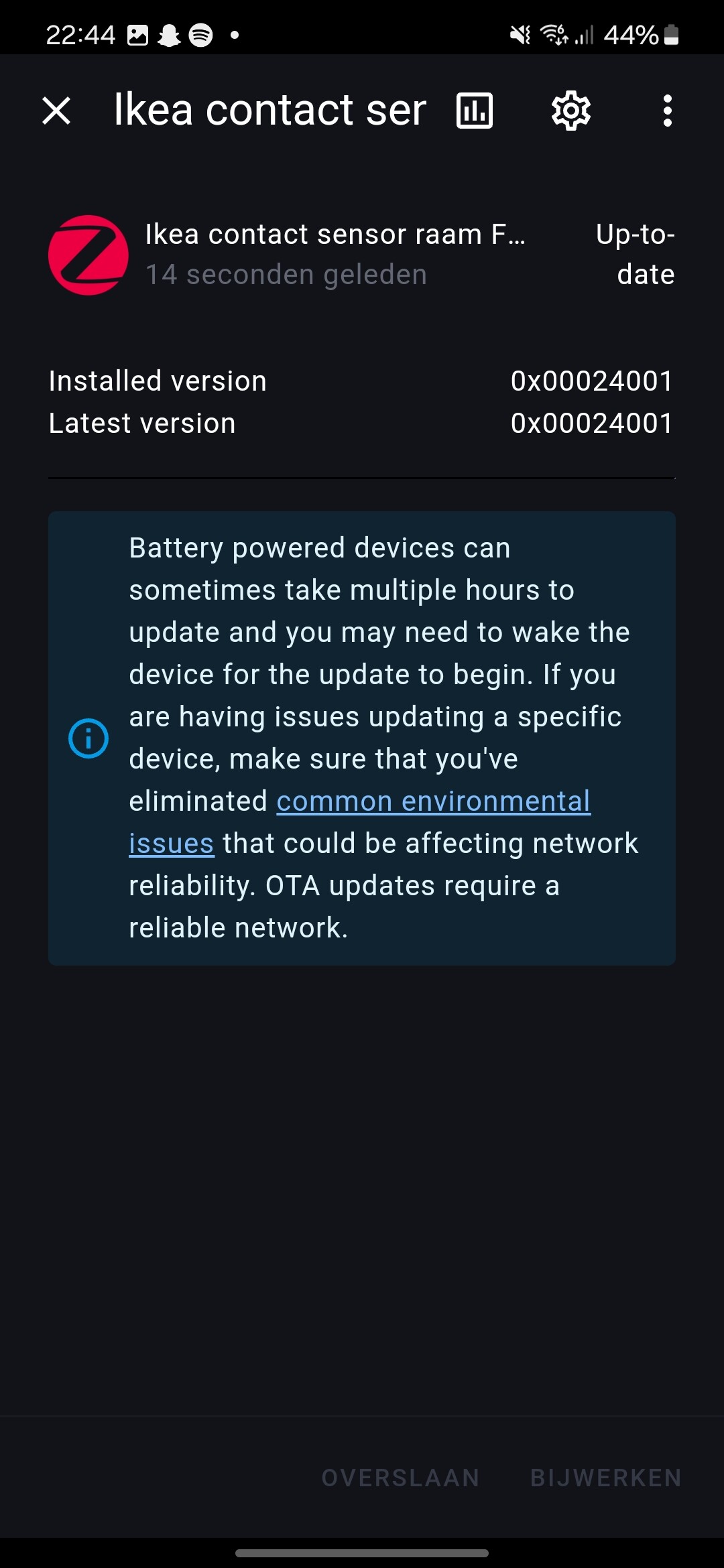

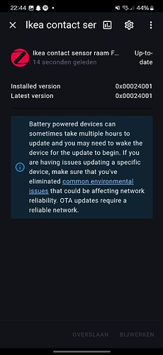

So, I recently bought a new Parasoll unit. When pairing for the first couple of times, the LED was behaving differently. It actually paired succesfully using ZHA. The led on the unit blinked once when closed, en twice when opened (but without fading). However, it showed up as IAS Zone in the config. The firmware version showed as 0x00024001. After pairing and unpairing a couple of times, I long pressed the pairing button, and the LED reacted by a fading blink. Now when opening and closing, the LED would blink with the usual fading behavior which I am familliar with because of a differenr one I am using. Now I reset again, and as described above paired it to ZHA. (Without actually succesfully connecting). Now it shows as a contact sensor, with firmware version 0x1000019. Below are some screenshots.
This all seems very weird to me, how can there be different behavior of the LED, and how can there be two different firmware versions on the same device?

So I click on Sensors → IAS Zone and then the cog on the top right and changed the Entity ID to binary_sensor.ikea_of_sweden_parasoll_door_window_sensor_onoff (previously it ended in something IAS related - I didn’t write it down). From changing the Entity ID to the new value the flipping thing started working going from On to Off when using it (Open/Closed respectively when set as a Door or Opening).

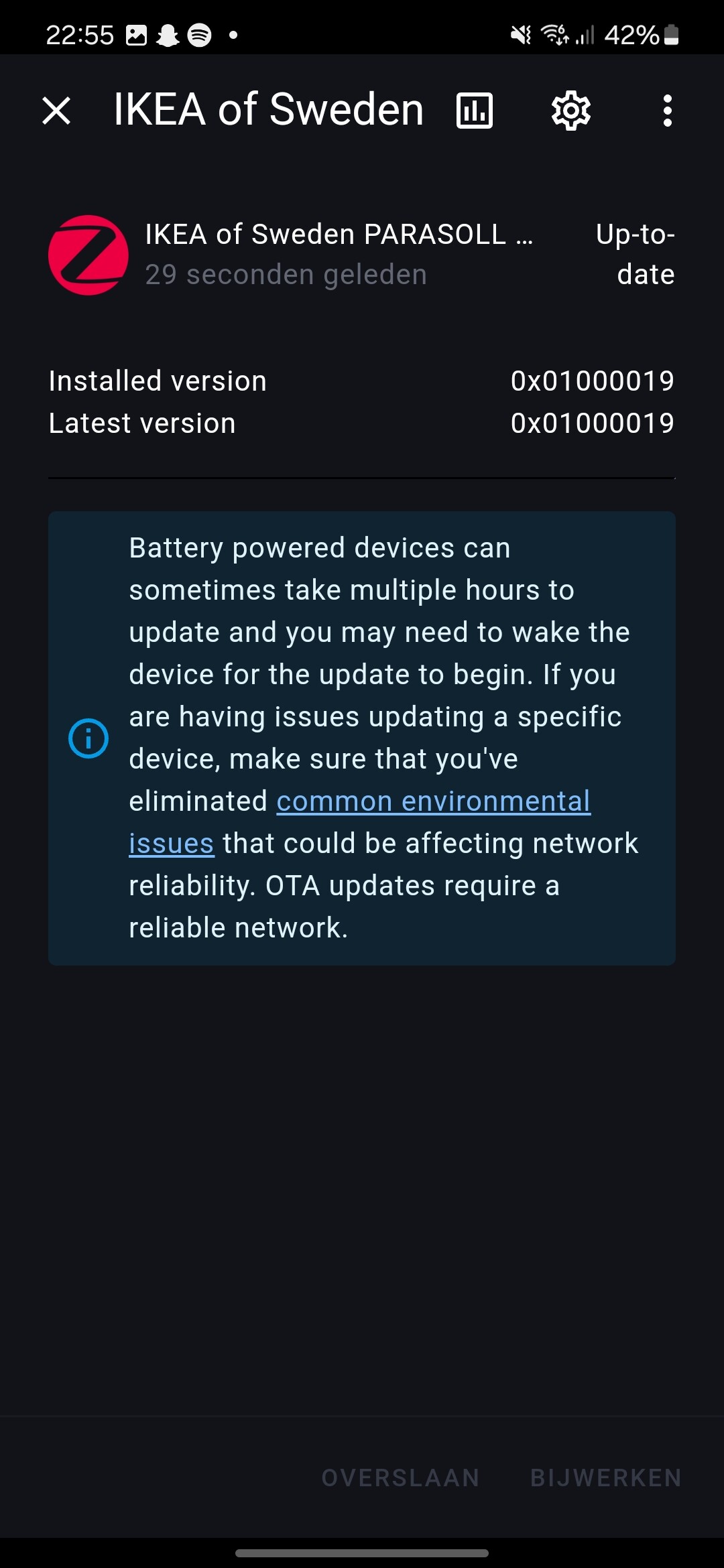

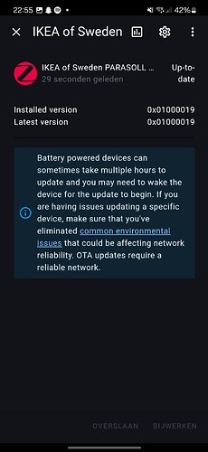

A few hours later it also shows the battery % and Firmware (Up-to-date Installed version 0x01000019).
