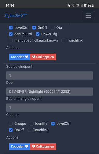

@Serega and @iamnewtoautomations and all others that not know this.
You can connect the rodret directly to hass/z2mqtt AND directly to the desired lamp.
You have to link them in de config minder bindings.
Example for z2mqtt
Hi @MrBearPresident, I’ve tried that, but I can’t control the brightness this way. Only off/on
Did you also bind the levelCtrl?
I have this working for me.
I did it like this. I want to control an Ikea 30W LED Controller
