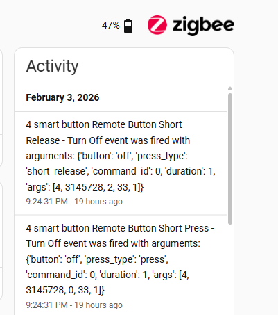

My Ikea STYRBAR E2002 no longer functions. Reinstalled in ZHA but unfortunately. See the status of the battery neatly but it doesn’t respond to anything anymore.
When I operate it I get the following error message:
Stopped because an error occurred on February 4, 2026 at 13:10:23 (executed in 0.03 seconds) UndefinedError: ‘dict object’ has no attribute ‘event’ Anyone have an idea what is going wrong?

look at ‘device’ info and the activity window.
If pressing a button gives activity, it’s not the device doing the ‘not working’ but your automation. Then indeed like hellis says, look at the blueprint provider
Is the actual blueprint in the link, which is not working and therefore it’s broken?
