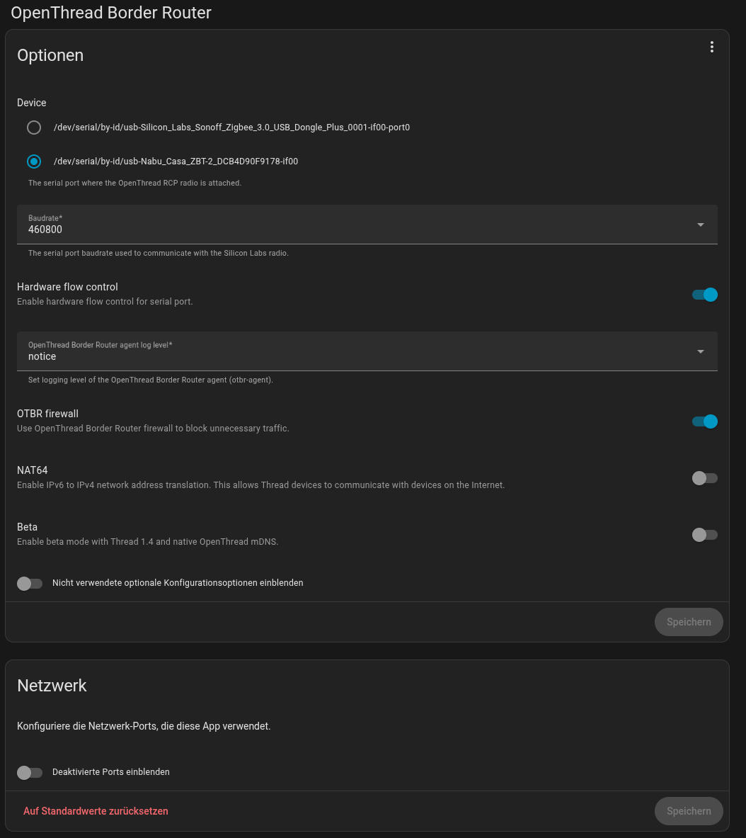

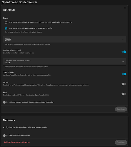

Do you have any other border routers or just the one?
@anis thanks for the answer. I’m only aware of this one router.
I have no other bridge or something like a nest device nor a second thread network on homeassistant.
This is my configuration of the OTR:
