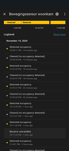

Just got my first VALLHORN sensor with new LADDA 750 mAh batteries. After pairing the sensor stays on “detected”. The Lux values do update but seem to be all over the place, going form 213 to 2 within 30 seconds whilst nothing changed in the room. I’ve also tried to repair the device trough another router device, rebooting Home Assistant and also another set of rechargeable batteries (LADDA 900 mah) without succes.
I’ve noticed the logbook keeps updating every 30 seconds with:
Bewegingssensor woonkamer Attribute Updated event was fired
11:24:07 PM - Now
Bewegingssensor woonkamer On With Timed Off event was fired with parameters: {‘on_off_control’: <OnOffControl: 0>, ‘on_time’: 600, ‘off_wait_time’: 0}
11:24:07 PM - Now
For what it’s worth, the VALLHORN firmware is 0x01000064 and I’m using Sonoff Zigbee 3.0 USB Dongle Plus V2 (the -E variant) with USB extension cable in combination with ZHA on Home Assistant 2024.11.1.
Only when I try to repair the device, without deleting it first, I get it to work once. I’ve tried that a couple of times:
Also playing with the buttons on the back, like @Pelle900 did, seems to do something once.
Since I’m using the right batteries I’m thinking my unit is faulty.
