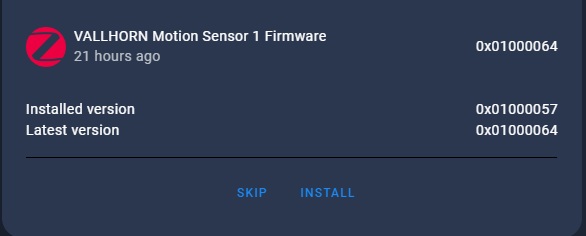

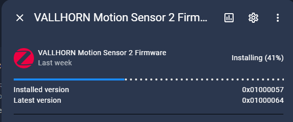

Has anyone tried to update the firmware on these? I started getting a notification yesterday that there was an update available:
However when I hit ‘Install’ I get an error:
File "/usr/src/homeassistant/homeassistant/components/zha/update.py", line 177, in async_install
    raise HomeAssistantError(f"Update was not successful - result: {results}")
homeassistant.exceptions.HomeAssistantError: Update was not successful - result: <Status.FAILURE: 1>
I’m using ZHA.
Mine work great on the current firmware so I don’t usually update what doesn’t need fixing
Actually managed to find some more info here. Will be keeping an eye on that to see how it develops.
Edit: in case it helps anyone, proximity to the controller does it fact help with the firmware update:
