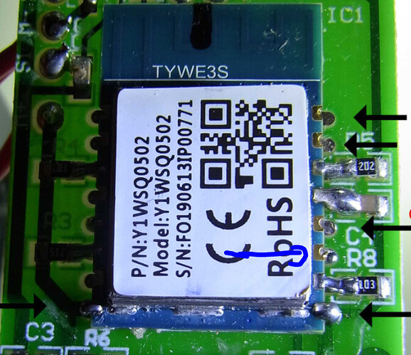

well looking around Ebay found one of these
for $2.76 NZL think could i add it to the Ilonda fish feeder
looking at the Look here blakadder site
i see a spare GPIO
after some more reading and asking Google
3rd up from the bottom GPIO2 let use that
my road map
let pull it a part and make it fit
eve ball for shorts
test it does it work change the module back to Generic Module
set the old value and add the DS18x20 to GPI02 prayed
did a reboot still praying the TASMOTA GODS
and SHIT it work
as there a temp sensor in there it was .7 out so more reading
so I did a tempoffset .7 in the console and they match HAPPY HAPPY CAMPER
it mounted back in place
putting it in HA
