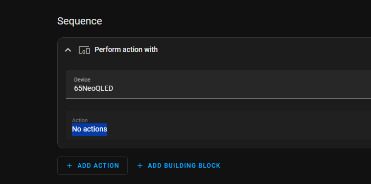

Hi, I also tried the SmartThings integration, and it works with the ā€œdefaultā€ card, but it does not allow/have any actions to use in sciripts:
Any idea how to get this integration work in scripts?
